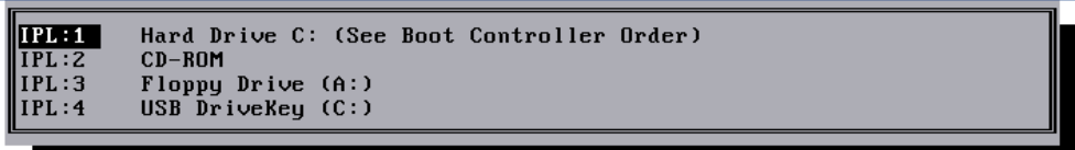

Boot controller order:
Boot order:

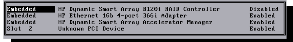

PCI Devices:
The "Unknown PCI Device" is the hba card.

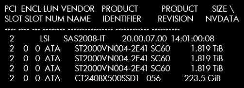

Drives Detected:
