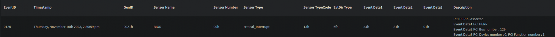

Well, I am getting some similar events now as well, so I guess I'll bump this thread with them since I also have no idea what they mean:
  • Sensor: 'Sensor #0' had an 'Assertion Event' (PCI PERR ; OEM Event Data2 code = 81h ; OEM Event Data3 code = 00h)
  • Sensor: 'Sensor #0' had an 'Assertion Event' (PCI PERR ; OEM Event Data2 code = 81h ; OEM Event Data3 code = 01h)
(logged into IPMI and I think this is the one:)
