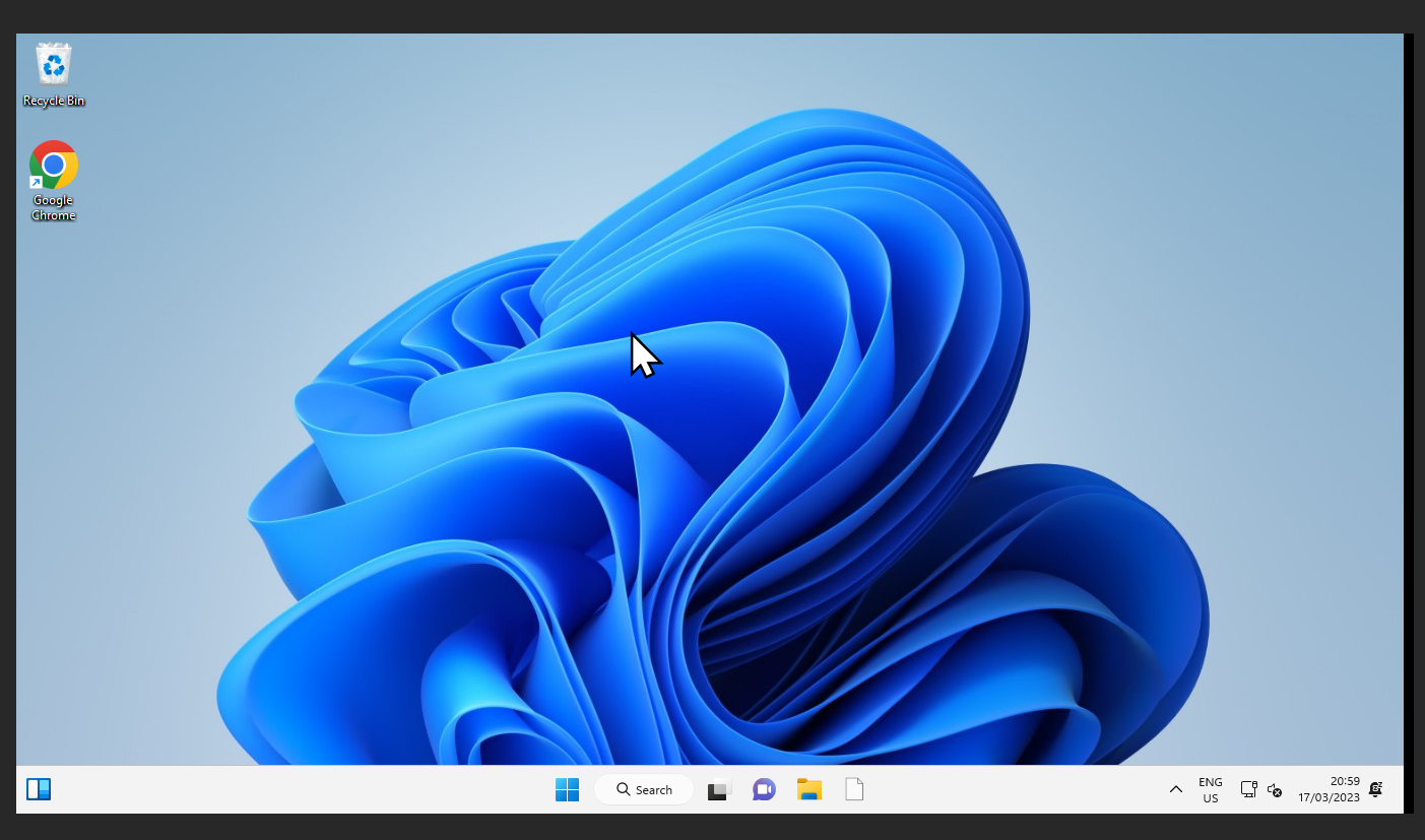

Mar 17, 2023
Setting mouse size to little larger brigns the cursor back.

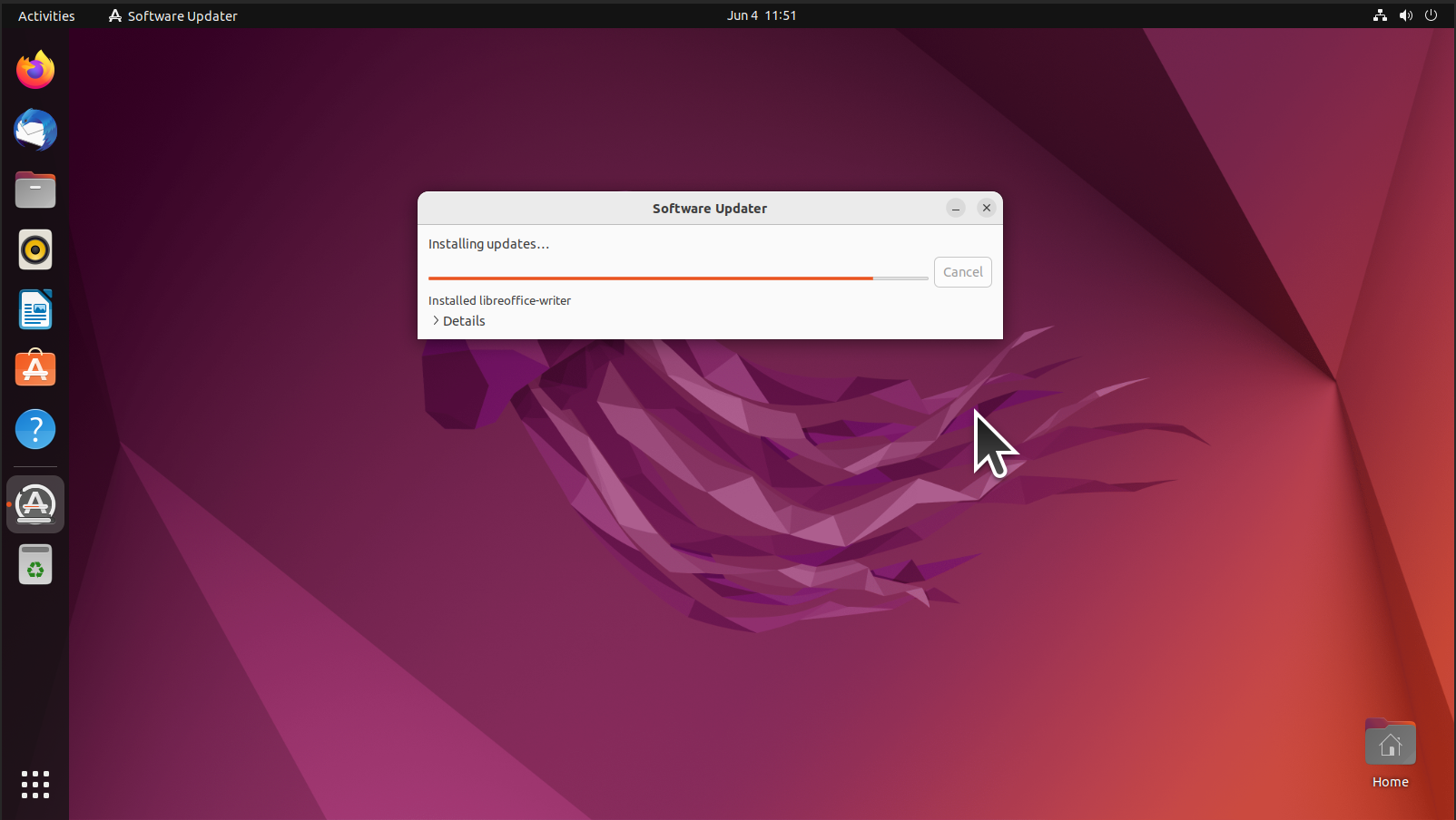

Same issue here with Ubuntu 22 using VNC on TrueNAS Scale 22.12.2 - Is there any fix? This large cursor is ridiculous, not to mention it blinks and lags as I move around the screen.
