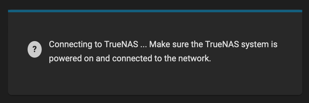

Recently (I think it started after the latest TrueNAS Scale update 22.02.1) I am stuck at the "Connecting to TrueNAS ..." Screen for like forever. Some times I came back after an hour or so and then I am able to login.
Files, SMB Shares, Docker Apps etc. are all fine and accessable. But the GUI is not responding ...

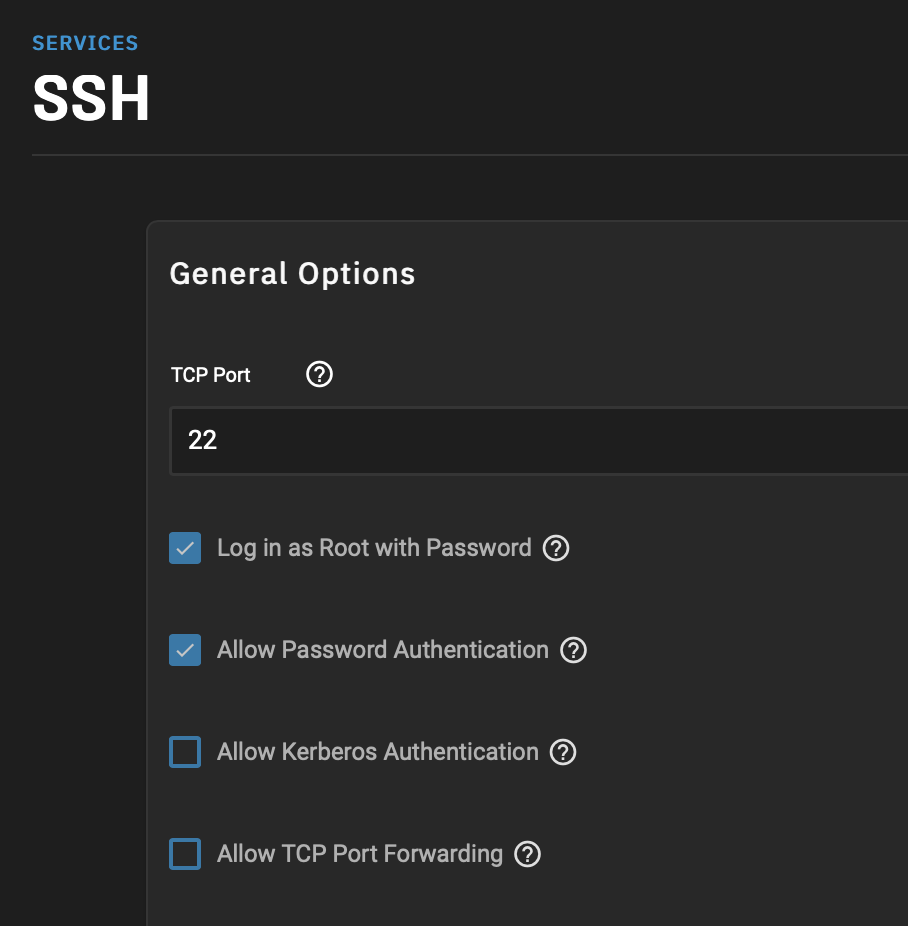

1. Did you enable SSH access? If not, do so.

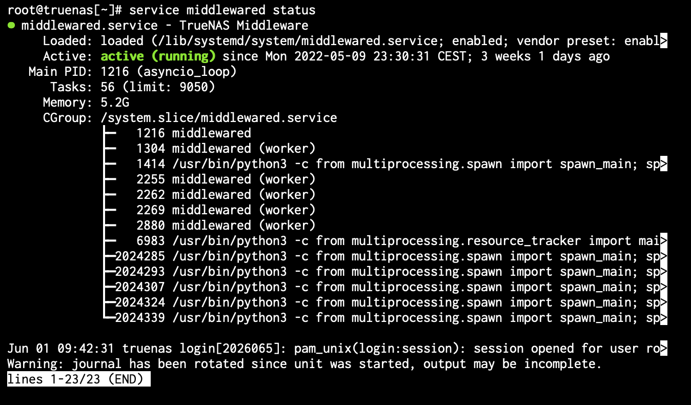

service middlewared status feedbacks:

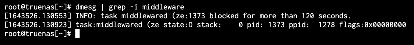

dmesg | grep -i middleware feedbacks:

Middleware seems to be taking an excessive amount of memory and you only have 8GB total. 8GB is the minimum for a basic system and you are also running Docker containers. My system only takes 1.6GB.
Memory: 5.2G

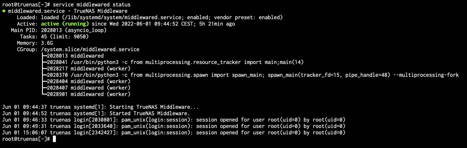

1.6GB was also shown shortly after I restarted middleware.
Now after 5h+ it shows 3.6GB:

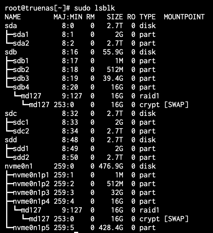

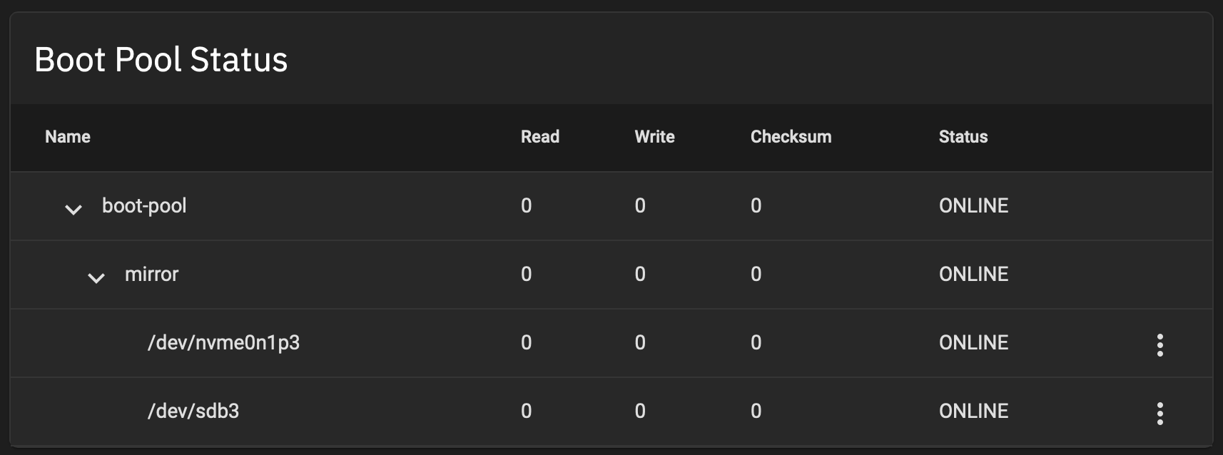

Regarding boot drives, I have a Samsung SSD 950 PRO 512GB with 32GB partition and a backup boot SSD:
nvme0n1p3 is the boot partition on the M2 512GB SSD and sdb3 should be the mirror on my 60GB SSD.
Regarding the partitioning process I followed this guide (5:45):
3. Did you install any other packages that are not part of TrueNAS?
What are you referring to as other packages? Basically TrueNAS Scale with the Boot Partition "hack". Nothing else.

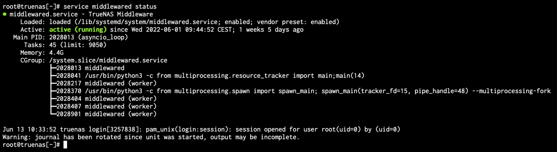

So after 12 days the system is slow again and current status "service middlewared status" feedbacks:
