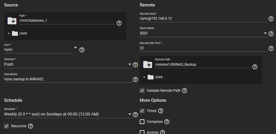

I have been trying to setup rsync setup to backup my TrueNAS (billnas or 192.168.0.10) box to a Synology NAS (billnas2 or 192.168.0.12). I followed this guide: https://blog.filegarden.net/2021/02/24/backup-truenas-to-synology-via-rsync/
I am getting an error when I run the Rsync task:
This error started after I messed with the known_hosts file on the Truenas box. I removed the lines in the known hosts file, then I even tried to delete the file, hoping it would recreate itself (which it did not). The error I receieved before I messed with the known_hosts file was:
I am able to SSH from the truenas box to the synology box manually, but when I try to do it from the rsync task it fails. I am using rsync as the user in both cases. Example:
That works just fine (also works if I use IP instead of domain name).
but this does not:
Thoughts on how to resolve this?
