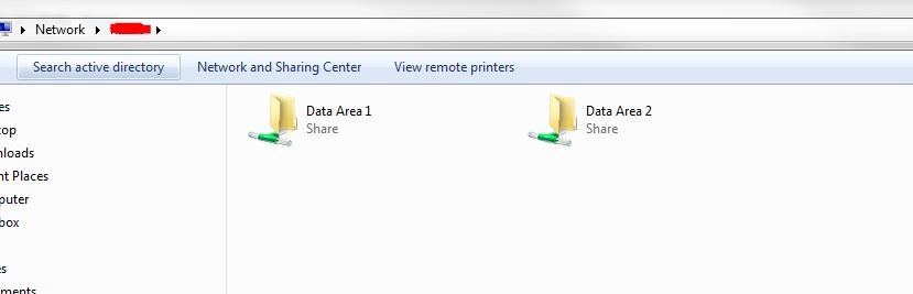

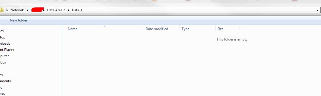

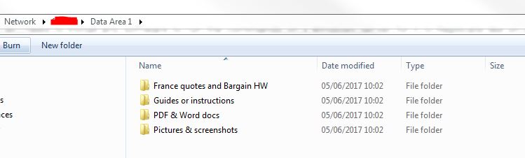

Ok, so I've gone through the Replication option to replicate a local volume to another, Data_1 to Data_2 and the status is "up to date" but doesn't appear to have worked.
I did have the Remote key issue "No ECDSA host key is known for servername and you have requested strict checking" before but appears to be ok now and is now in an "up to date" state.
It appears to have made a folder called "Data_1" but there is nothing in there, Screenshots attached.
Thanks
James

James Richardson
Apr 10, 2017
59
Sorry been impatient, it's done it now but it was only 160MB, didn't think it would take an nearly an hour to do that.
