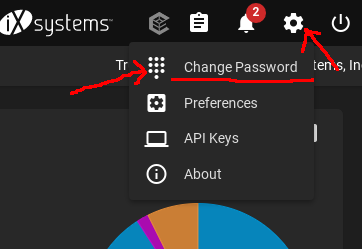

@david001 I would like to share what I recently experienced and noticed on a similar topic.
I changed the root password from the shell using a "passwd" command and assumed the same would be also applicable for Web GUI login. However, I noticed that was not the case and I was able to login to the Web GUI only with my old password for "root" account.
So looks like the shell password for "root" is different from the Web GUI password and to change the Web GUI password for "root" I was able to do it from Web GUI per the attached image.
Hope this helps.
Hope this helps.
Hi, thanks very much for the reply and info.
For me, I was unable to login to the Web GUI with the root password. Actually I also had another user account with a saved password and was unable to login with that as well. I did change it from the 7 option on what I think is called the "console". That is the options displayed on the output of the video card from the NAS itself and usable through a keyboard connected directly to the NAS.
I am in, but really at a loss as to what occurred and am concerned there was someone accessing the NAS, but it would have had to have been remotely.
