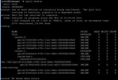

1. How to speed up resilvering?
2. was unable to detach the old drive (I think) from the GUI, GUI wont respond when trying to look at disks ATM.

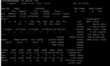

Your pictures were significantly downsized by the forum :(.
If you shutdown and physically remove the bad drive you are trying to retire your resilvering should perform MUCH faster. I try not to resilver with a bad drive if I don't have to. That's why I use RAIDZ2 so I can remove a drive and still have redundancy from a second failure.

[root@freenas] ~# systat -vm
    1 users    Load  0.20  0.31  0.28                  Jan 17 21:39
Mem:KB    REAL            VIRTUAL                       VN PAGER   SWAP PAGER
        Tot   Share      Tot    Share    Free           in   out     in   out
Act  205588   17328   828852    21356  12129k  count
All 3282700   18456 1074692k    30632          pages
Proc:                                                            Interrupts
  r   p   d   s   w   Csw  Trp  Sys  Int  Sof  Flt        cow    5500 total
             47       15k    6  267 1504 1615             zfod        ehci0 ehci
                                                          ozfod     1 ohci0 ohci
11.2%Sys   1.5%Intr  0.0%User  0.0%Nice 87.3%Idle        %ozfod  1998 cpu0: time
|    |    |    |    |    |    |    |    |    |    |       daefr    10 re0 irq256
======                                                    prcfr  1159 ahci0 257
                                           dtbuf    42309 totfr   334 siis0 258
Namei     Name-cache   Dir-cache    325517 desvn          react  1998 cpu1: time
   Calls    hits   %    hits   %      4262 numvn          pdwak
       2       2 100                   983 frevn          pdpgs
                                                          intrn
Disks   md0   md1   md2  ada0  ada1  ada2  ada3   3374472 wire
KB/t   0.00  0.00  0.00  1.56  1.75 66.87 65.82    149540 act
tps       0     0     0     5     5   342   342     65488 inact
MB/s   0.00  0.00  0.00  0.01  0.01 22.34 21.99      1104 cache
%busy     0     0     0     0     0    51    74  12128844 free
                                                   173072 buf
[root@freenas] ~# zpool status -v
  pool: Vol0
 state: DEGRADED
status: One or more devices is currently being resilvered.  The pool will
        continue to function, possibly in a degraded state.
action: Wait for the resilver to complete.
  scan: resilver in progress since Sat Nov 10 23:39:04 2012
        2.90T scanned out of 7.44T at 531K/s, (scan is slow, no estimated time)
        372G resilvered, 39.03% done
config:
        NAME                                              STATE     READ WRITE CKSUM
        Vol0                                              DEGRADED     0     0     0
          raidz1-0                                        ONLINE       0     0     0
            gptid/338243b8-e7fc-11e1-8afc-00045fb309e8    ONLINE       0     0     0
            gptid/33c3355c-e7fc-11e1-8afc-00045fb309e8    ONLINE       0     0     0
            gptid/342046fb-e7fc-11e1-8afc-00045fb309e8    ONLINE       0     0     0
            gptid/34a6ad54-e7fc-11e1-8afc-00045fb309e8    ONLINE       0     0     0
          raidz1-1                                        DEGRADED     0     0     0
            gptid/518cbece-e7fc-11e1-8afc-00045fb309e8    ONLINE       0     0     0
            replacing-1                                   OFFLINE      0     0     0
              2406282357351593836                         OFFLINE      0     0     0  was /dev/gptid/52120a83-e7fc-11e1-8afc-00045fb309e8
              gptid/7b92c455-2bca-11e2-ad71-00045fb309e8  ONLINE       0     0     0  (resilvering)
            gptid/5270dda3-e7fc-11e1-8afc-00045fb309e8    ONLINE       0     0     0
            gptid/52e8cd24-e7fc-11e1-8afc-00045fb309e8    ONLINE       0     0     0
errors: No known data errors

If you use the code tags then it'll be all pretty again.
I didn't see anything amazingly wrong. Not sure about the CPU performance(not an AMD person) but I'd still expect it to do much much more than what you are seeing performance-wise.
If you reboot FreeNAS the resilvering will start from zero. I'm not 100% sure it will start resilvering again automatically so I'd check it if you reboot and manually trigger a scrub if it doesn't.
