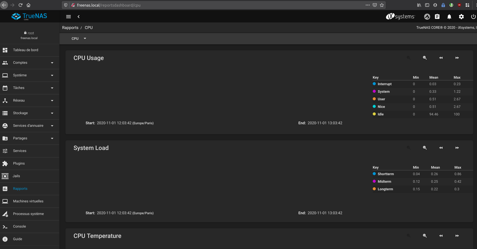

I've recently upgraded my Freenas 11.3 to Truenas 12.0. Now, when I click on Report, plots are not displayed anymore.

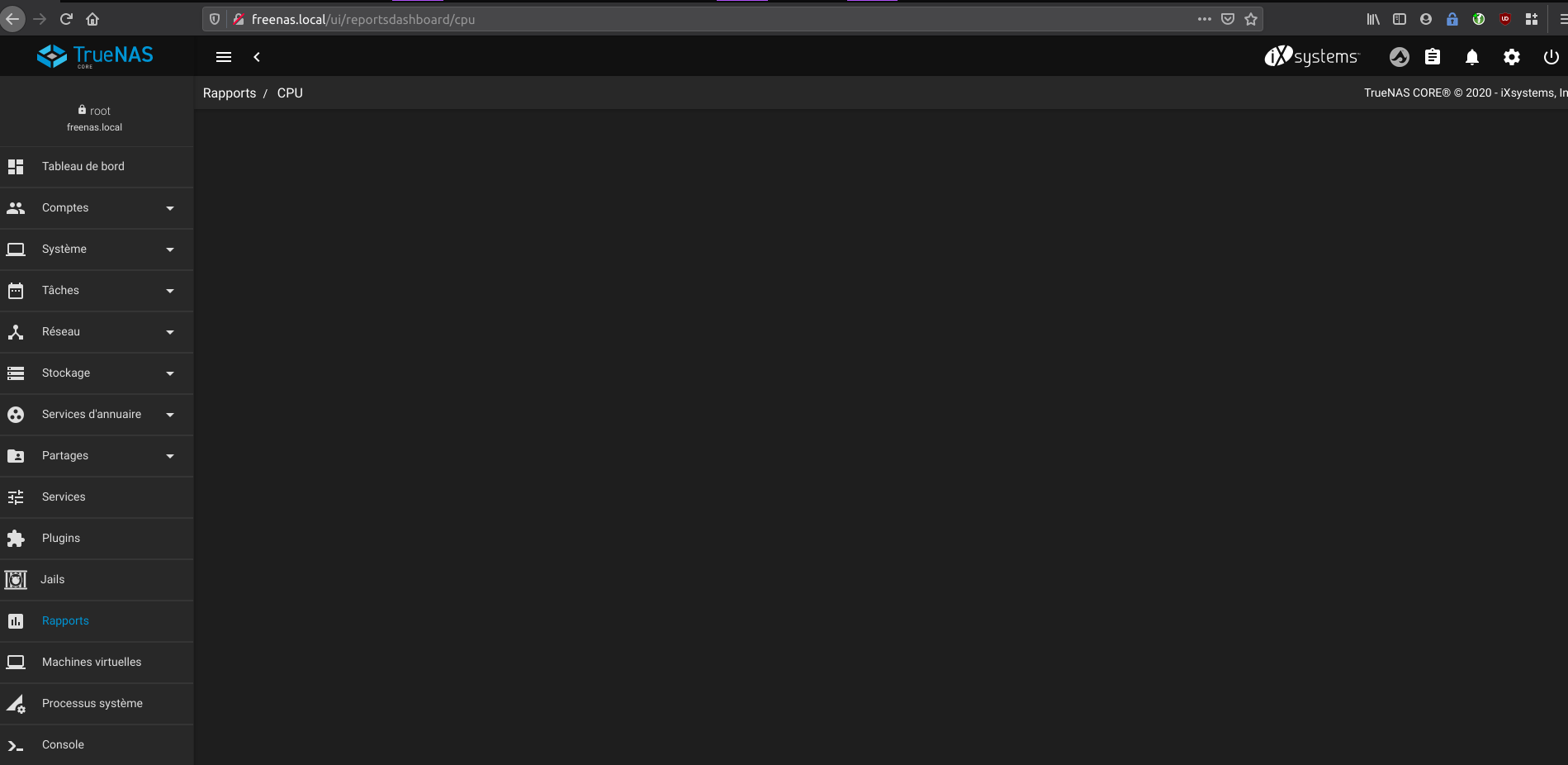

Notice URL http://freenas.local/reportsdashboard/cpu without path ui just after http://freenas.local/, whereas this ui path is present for all other URL.
Moreover, when I enter this URL, and that I click on "Dashbord" ("Tableau de bord" on this picture) for instance, I get this
Notice here that ui appears and that the last part of the previous URL is preserved.
Is somebody able to explain to me if this bug is solvable? And How?
