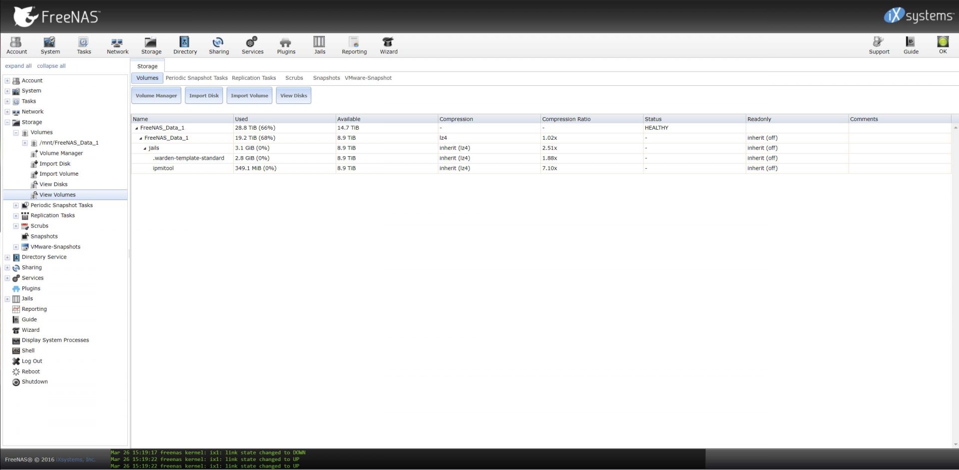

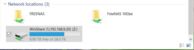

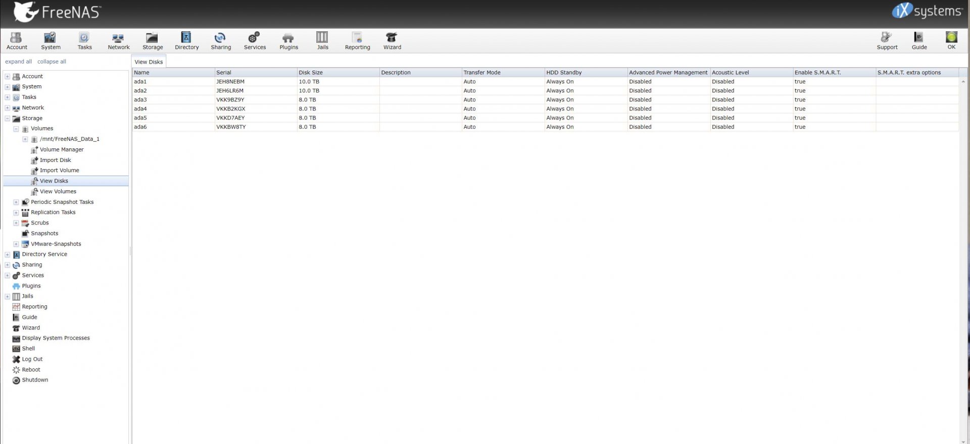

I had a 6 8TB drive array in my FreeNAS.
I've just now replaced two drives to 10TB using replace-resilver.
As shown in the pics, on the windows machine nothing changed when accesing the FreeNAS and i can't seem to find where can i change the volume size to the maximum or the WinShare size accordingly.
Any help would be much appreciated.
Thanks!
Eli

But i don't want (and can't) replace all disks at once. Isn't there a way to tell FreeNAS to expand the volume according to the actual disks that are installed? I can't see the reason why it would have to make me replace ALL the disks...
I do have 2 more 10TB disks that i can utilize if that helps somehow, but they can't be permanently in the NAS.

Your path of least resistance: If you revert back to a 6 x 8TB RAIDZ2 vdev in the pool, you can add a second 10TB mirror vdev to the pool. To understand why this works review ZFS Storage Design

I don't understand how that helps. eventually i will need to have X4 8TB and X2 10TB, how could i lose the 2 8TB later on?
And actually in any case, i can't put the two 8TB back in because tomorrow they have to be installed in a different machine.

Review the links to understand what you can and can't do...
Replacing Disks to Grow a Pool
ZFS Storage Design
Basically, there are only two ways at present to grow a pool:
  1. Replace ALL disks in a vdev with larger capacity disks; and/or
  2. Add another vdev to the pool.

I don't know what is the technical reason for that, but I'll just have to make due with it.
It is because data is written across all drives, so there needs to be an equal amount of space on all the drives. It can't just write to the two drives that have more space. It must be able to write to them all equally.
