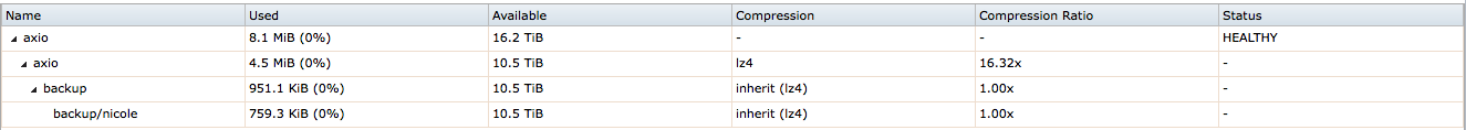

I have search the internet extensively but believe my problem is unique. I'll try to keep it short but I need to provide a little background.
I recently expanded my main pool from 4x3tb RAIDz2 to a 6x3tb RAIDz2. I am now replication via snapshots from the backup freenas system that I have to the main box with the new setup.
The problem I'm having is I want to restore my original structure tree but am having trouble doing so.
Here is what I get when I replicate on of my datasets from the backup box to the new box:
I want it to look like this:
axio>axio>nicole
So I want to do multiple things. Rename the dataset "backup/nicole" to "nicole" and then move it out of the dataset "backup" to the "axio" dataset.
I am getting errors when using the "zfs rename" command because it thinks the "/" in the name is a file path and thus doesn't exist.
Would really appreciate sorting this out.

Have you tried to use "backup\/nicole"?
nojohnny101
Dec 3, 2015
1,477
I have, still gives me "does not exist"
here is the command I'm using:
zfs rename axio/backup/backup\/nicole axio/backup/nicole

What's the output of zfs list?
I just did a quick test and it worked, but I created the nested dataset in freenas, it wasn't replicated into it. maybe that makes a difference in the zfs listing structure.

well I think you are on to something @depasseg
here is the output:

ok so I redid the command referencing the output list and it worked. As I referenced above, I also wanted to move the data so it is just: axio>nicole.
It seems I did this, but I'm confused how easy it was. It just seems like it changed a "reference" or "pointer", not the actual data?
here is the result:
