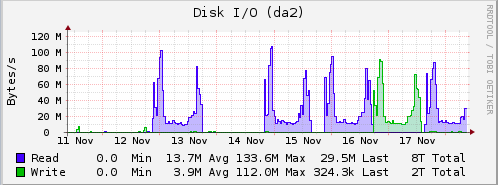

Not sure why my production pool resilvers like it does. Starts super fast, slows down for a while and then finishes strong.
It takes 20 hours +/- a few minutes every time. My backup pool takes about 6 hours.

droeders
Mar 21, 2016
179
My guess would be the size of the files it's resilvering. If I had to wager, I'd say it's resilvering large files when the performance is high, and lots of small files during the slow periods.
Scharbag
Feb 1, 2012
620
But my backup tank has all the same data on it and it averages over 900MBps... Oh well. Not a big deal.

fracai
Aug 22, 2012
1,212
Wouldn't resilvering iterate over blocks? Not files?
Is the pool greatly fragmented? There is work being done to improve resilvering: https://www.youtube.com/watch?v=SZFwv8BdBj4
droeders
Mar 21, 2016
179
I don't think it's that simple. Since ZFS only resilvers disk blocks that are in use, I would expect it to do some type of filesystem walk (rather than just go from the first LBA to the last like a traditional RAID).
This article talks about "Sequential Resilvering", where random small IO was killing ZFS resilvers until they broke up the process into two phases. In the first phase, the list of blocks that need resilvering is generated, and in the second phase, the blocks are sorted and grouped together allowing for much more efficient usage of the spindle.
https://blogs.oracle.com/roch/entry/sequential_resilveringfirst
I didn't have time to watch the video you referenced - maybe it's talking about the same thing.
All that said, if the OP isn't seeing the same performance with a similar machine holding the same data, it's probably something else.
Scharbag
Feb 1, 2012
620
My scrub performance with the production pool being discussed has always been slower than the backup pool. And it acts the same on 2 different servers. Not a big deal given it is for home use.
