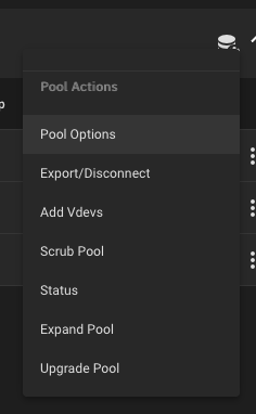

Sure is. Go to the Storage page, and in there click on the gear icon toward the right:

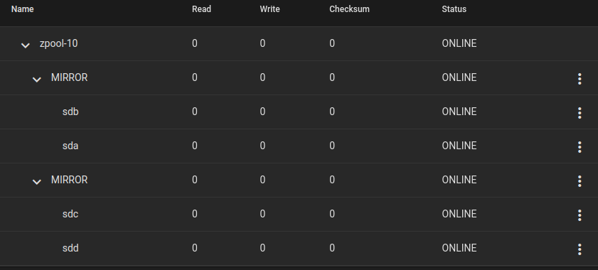

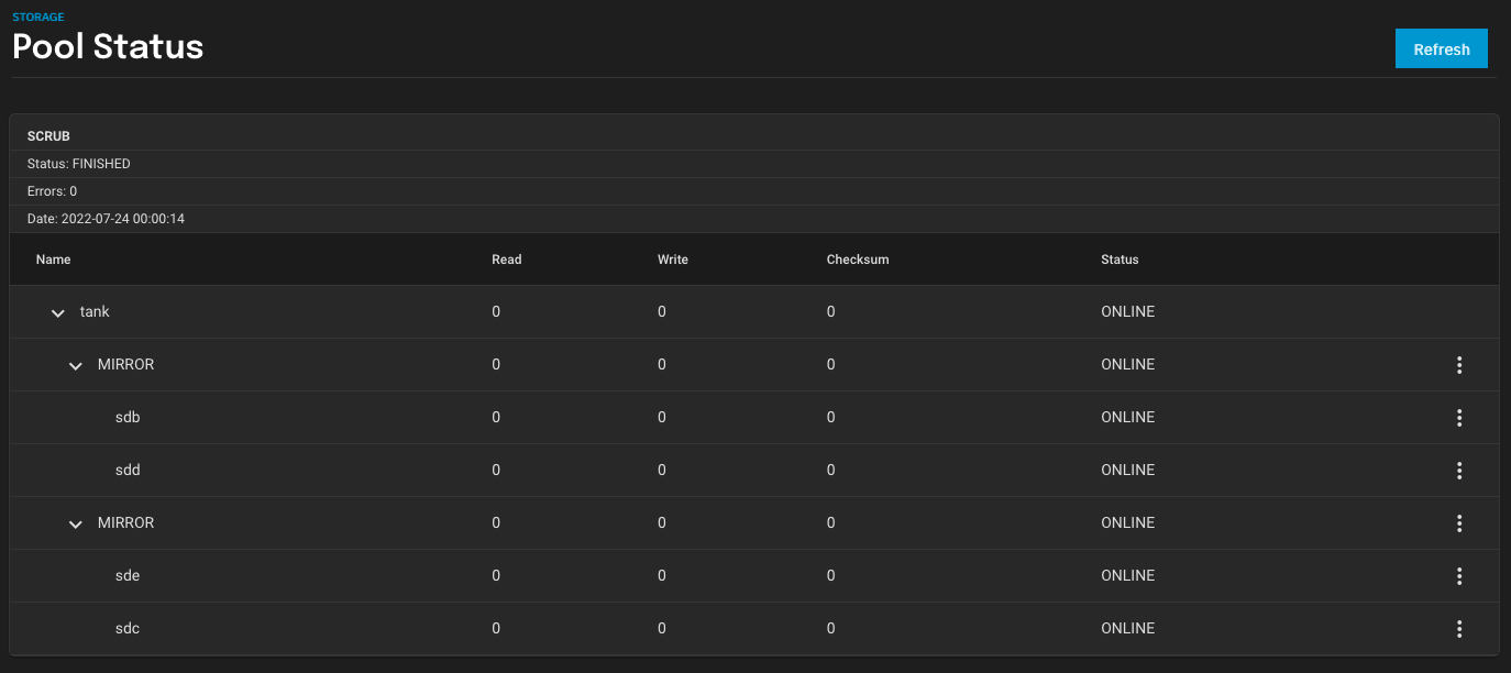

From that menu, choose Status. You'll see a page like this:
Click the kebab menu to the right of the vdev you want to remove:
Select Remove from that menu. Confirm the operation, and you're good to go.

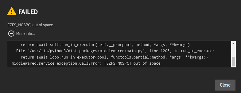

Thank you -- I tried this on the second mirror, and when I attempt to remove either disk, I get this error:
The pool has about 800GB free .. so not sure if I have to unmount anything first ??

How big are the disks in the mirror you're trying to remove? If they're 1 TB or larger, the error is right (though it shouldn't have generated a traceback)--there just isn't enough space on the remaining disks to store the data on the disks you're trying to remove.

You don't "detach" it, you "remove" the entire vdev--as I wrote above. But everything you're writing sounds like you have more data than will fit on one mirrored pair of your disks--where do you expect that data to go when you remove the second mirrored pair?
