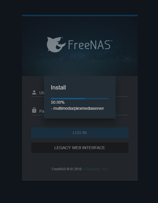

Did anyone else have issues after upgrading to 11.2 and plugins? I previously had plex installed and removed it prior to upgrade. after upgrade when I went to install the plex plugin I get
Release 11.2-RELEASE missing, will attempt to fetch it
and it just sits there for hours at 50% and never installs. This is the same for all the plugins now. Everything was working fine before. Any help is appreciated

I did the 11.2 upgrade. I then went to plugins and install. that is when I get the error.

Sorry, that does not tell the full story of how you got there.
Also, you are not logged in to the UI and it is possible the message may simply not update because you are not logged in.
I went to plugins (see screenshot) like normal and click on the 3 vertical dots and then click install. The install starts but then kicks it back out to the login screen and just sits there. This is for all plugins not just PLEX also.

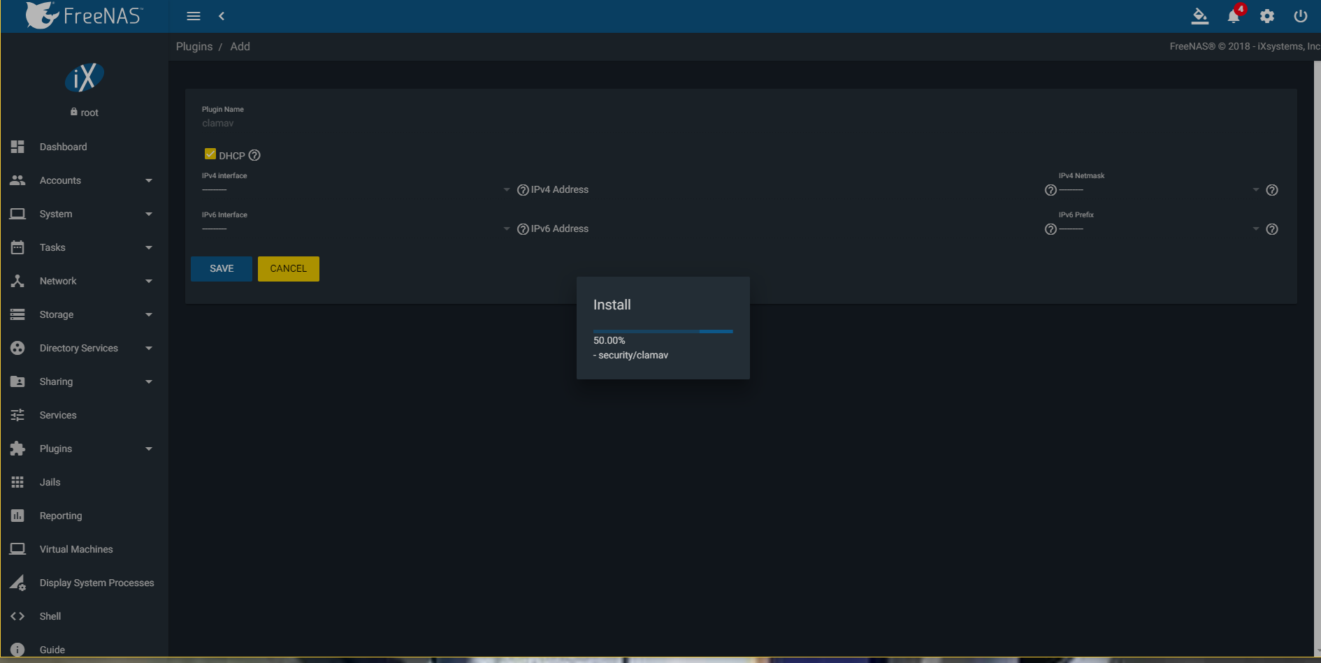

"Release 11.2-RELEASE missing, will attempt to fetch it" stuck at 50%...
This is on a test system with a fresh pool made from the gui...
Same here.
Fresh install of 11.2-U5, newly formatted pool and ALL jail installation stuck at 50% with this error message.
