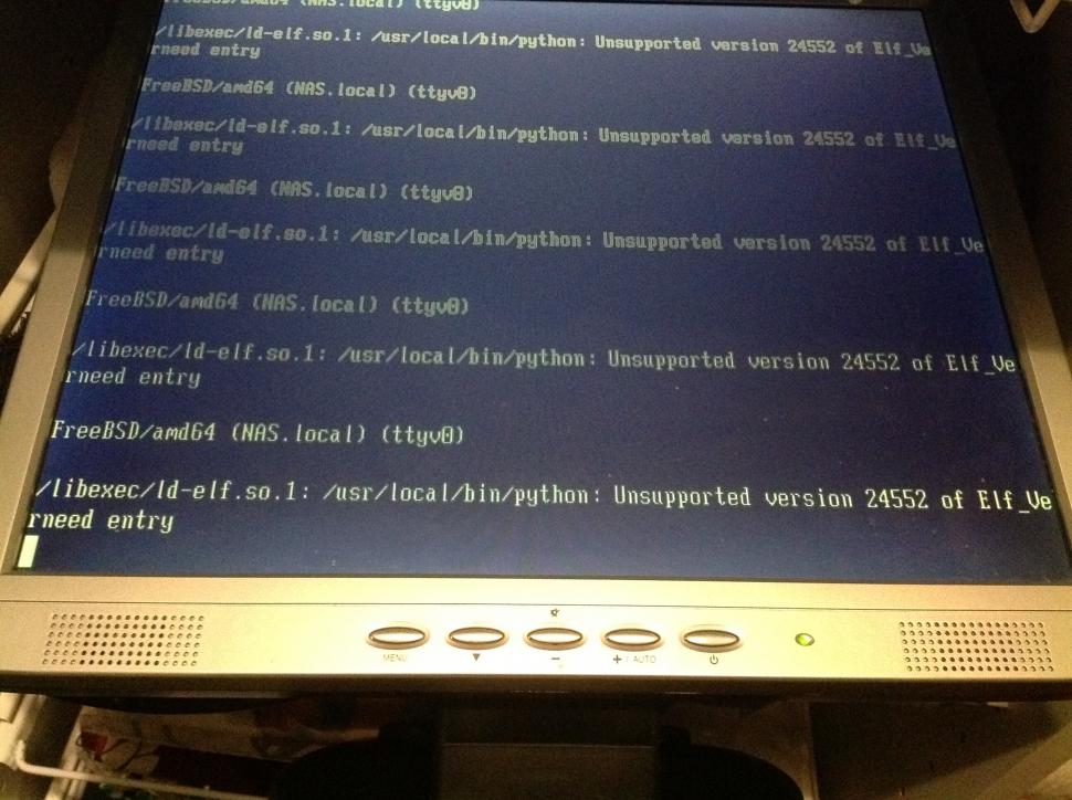

I've connected a screen to the system now and this is what it say:
libexec/id-elf.so1: /usr/local/bin/python: Unsupported version 24552 of Elf_Ve rneed entry
(i'll attach a photo as well bild.jpg )

Should that really be flash drive failing?
Yes, we've seen it before. Re-install on a new flash drive and import your settings.
