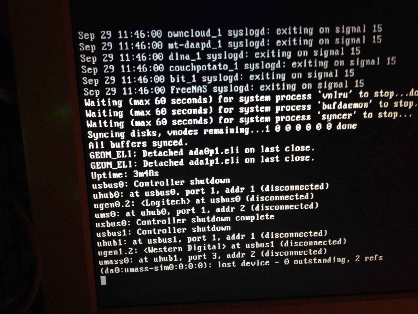

I am having a similar problem and spent hours and hours to solve it thinking it was a BIOS problem, but I am now sure it is FreeNAS. Every time I try either to shutdown or reboot, the system does not send the power off to the power supply and I have to physically switch off the machine, which is not really handy for a server. I though it was a BIOS setting and tried to upgrade firmware and all possible configurations, but then I tried to run UBUNTU a make a reboot from there and it works like a charm. It stops as shown hereafter. I am using a AMS Semptron 64bits with ALiveNF6G-VSTA BIOS P2.20. Any help would be GREATLY appreciated. Stefano

Mine is a little weirder.. I see you have a Lacie plugged in.. Not my fav.. It looks like its freezing whatever comes after it..
With my setup everything works as intended except for cronjob.. My friend says he's not turning the system back on.. As far as I know it cycles down.. and does a restart instead of a shutdown -p now.. but only sometimes..

If I disconnect the Lacie I get the same error with the Drive which is still connected. This means there is something wrong in the shutdown procedure for the external drives I am afraid:

On first instance 9.1.1 it configures beautifully installing from CD, the anonymous acces using CIFS works great, until the NAS is powered down. That is, it cannot be powered down, it hangs at exactly the same place as shown in the above picture.

[USER]STRAMIGIOLIS[/USER], there seems to be a problem with ZFS on USB drives in FreeBSD 9.1. This should help: sysctl hw.usb.no_shutdown_wait=1
