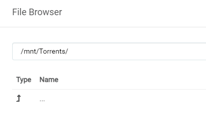

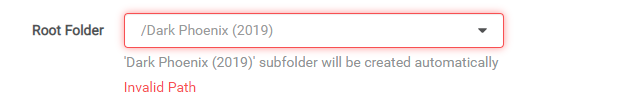

when I go to the Jail web site select Settings - Media Management - Add Root Folder and then select the mount it does not store it and then when trying to download a movie I keep getting told Invalid Path. As shown in the two pics below.

I don't think your root folder is set correctly... the full path should appear in that box... like /mnt/Torrents/Dark...
It could be that your permissions are somehow not good which is preventing your selected root folder from being used. What have you done about permissions in the jail(s) (torrent and Radarr)?

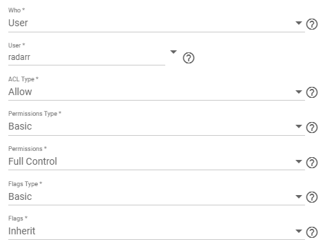

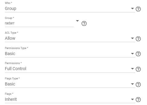

I have assigned them to the ACL. I have given them the following
I am able to copy to the share from my Linux machine using the above permisions.
