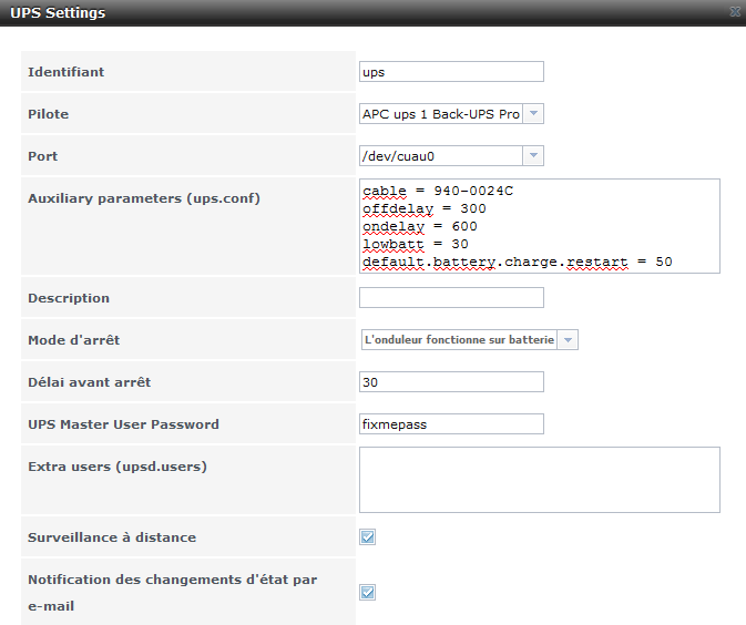

Bonjour, qui peux m'aider à installer un UPS APC pour ma configue FreeNAS-8.0.4.
J'utilise un câble 940-0024C. Après installation du driver apcsmart la connexion bloque.
Que dois-je faire?
@+MERCI

Jul 18 17:13:15 freenas freenas: Fatal error: 'offdelay' is not a valid variable name for this driver.

Jul 18 17:13:15 freenas upsd[35980]: Can't connect to UPS [ups] (apcsmart-ups): No such file or directory
Jul 18 17:13:15 freenas freenas: Can't connect to UPS [ups] (apcsmart-ups): No such file or directory
