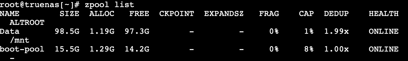

Hi guys
hopefully my last questions to you guys. However, I still have a question regarding the dedup ratio.
This is for me with a dataset at 1.99
is there a reason why it is not exactly 2.00? Is there a setting that can be made in this regard (though I haven't seen anything here).
thanks again!

Why would you expect it to be exactly 2.00?
Based on the size, I am guessing you setup a test environment. Note that some overhead blocks, (aka metadata like directory entry blocks), may not be de-duplicatable. Thus, if you had a file that you then copied over into a different path, (so same file data blocks), it would be de-duplicated. But, not it's directory entry.
Last, in general, people with questions about de-dup for ZFS should not be using de-dup for ZFS. It boils down to specialized knowledge, specific hardware requirements and an understanding when to beef up hardware.
Of course, if you are just experimenting for learning, go for it.

thank you very much for your answer. Indeed, I test certain settings and behaviors regarding the data reduction within the TrueNAS, so I am not enough in all details (yet)
I had in fact seen a video before where a rate of 2.00 was achieved although a similar approach was taken.
But I understand your arguments, makes sense. Thanks a lot! :smile:
