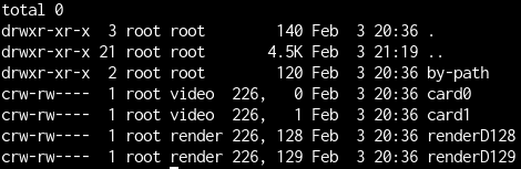

Hi all, I'm trying to determine if this is an issue with the image/handbrake or something I'm failing to do in Truenas Scale
TrueNas Scale Bluefin
12th Gen Intel(R) Core(TM) i7-12700
I ran the command midclt call system.advanced.update '{"kernel_extra_options": "i915.force_probe=4680" }' to enable the graphics.
The other card is an nvidia card I have isolated for virtualisation.

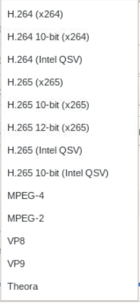

Going to Video Settings and the encode, it shows the Quick Sync options:

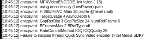

The problem is when I try to use the Intel QSV options, I get this error:
There was a known issue with Handbrake and this image, a work around was to go to presets.json and add lowpower=0 to VideoOptionExtra which I did but the same error.
I have also tried the Truecharts Handbrake but I think it to uses the same image.
Is there anything else I could look at for more info or has anybody got this working?
I have tried the docker to be run as root but same issue. Any non QSV encoders work.
