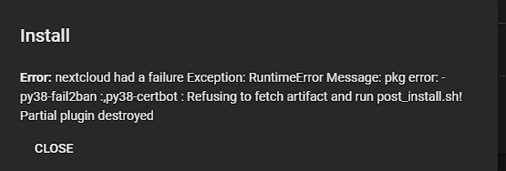

I just cannot insert the 9 in the file. How do you guys do that? I get the line --insert-- on the bottom and i cannot write :wq
Once you see insert use the arrow keys to put your cursor on the 8 and type 9, then arrow right over the dash and backspace to delete 8.
When you have changed both 38 to 39 hit esc, that takes you out of insert mode
arrow keys down until cursor is at the end and type :x
that saves the file
Run the update on the plugins page through Turenas
When mine finished is stated no update available for xxxxx
Launch nextcloud dashboard and click start update
DONE
