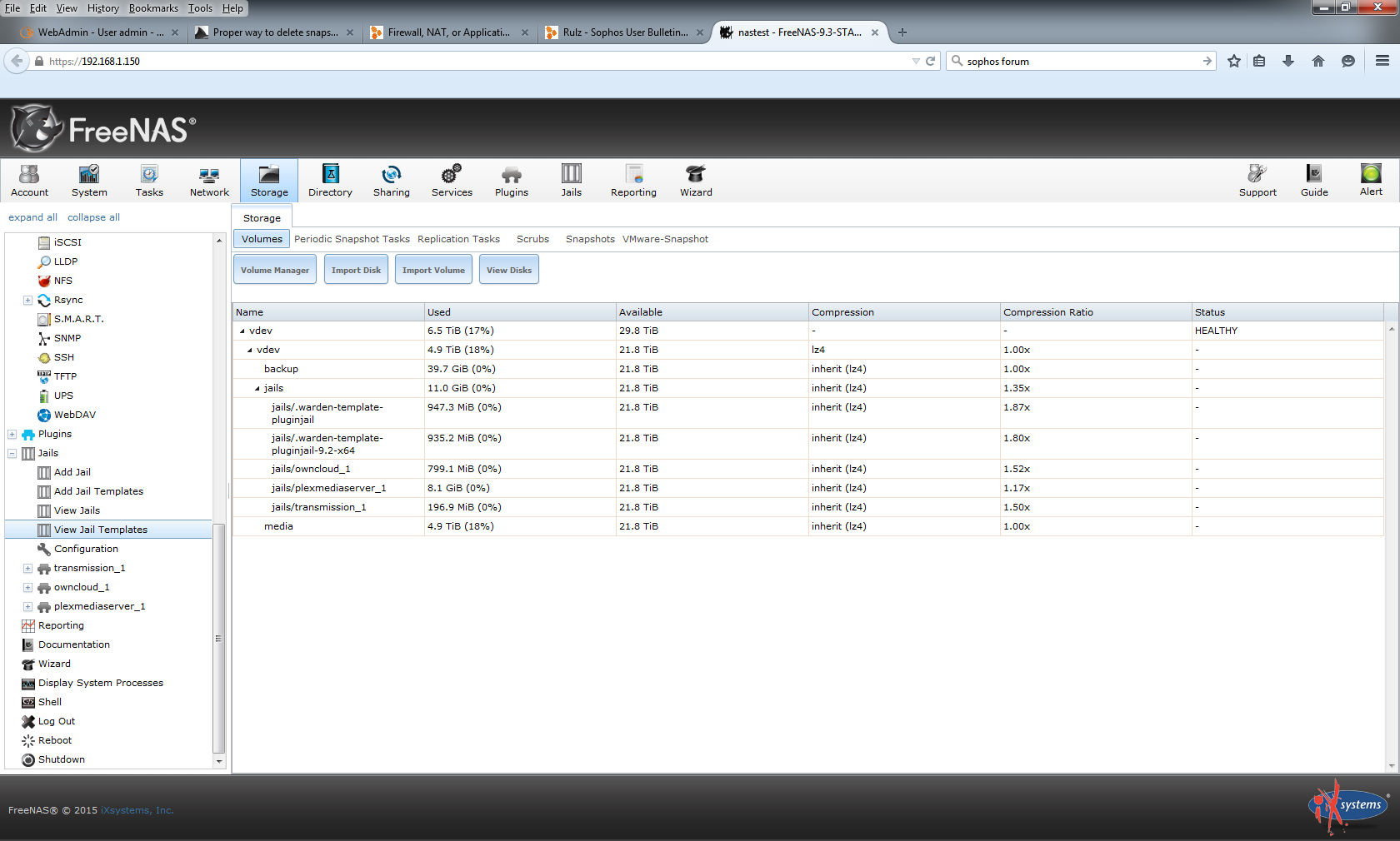

I have two snapshots that provided two different errors:
cannot destroy 'vdev/jails/.warden-template-pluginjail@clean': snapshot has dependent clones use '-R' to destroy the following datasets: vdev/jails/
cannot destroy 'vdev/jails/.warden-template-pluginjail-9.2-x64@clean': snapshot has dependent clones use '-R' to destroy the following datasets: vdev/jails/owncloud_1

I tried to destroy both datasets, but I receive the same message in the storage tab. So, I can't destroy the dataset, or the snapshot? What does the "-R" mean?
It's weird. These datasets do not appear in the jails tab. I am not sure when they were created. I believe during a plugin install. Regardless, I can't seem to destroy them. They are the two above owncloud

do you have plugins or jails installed? you will need to remove them before you can delete those two snapshots.
