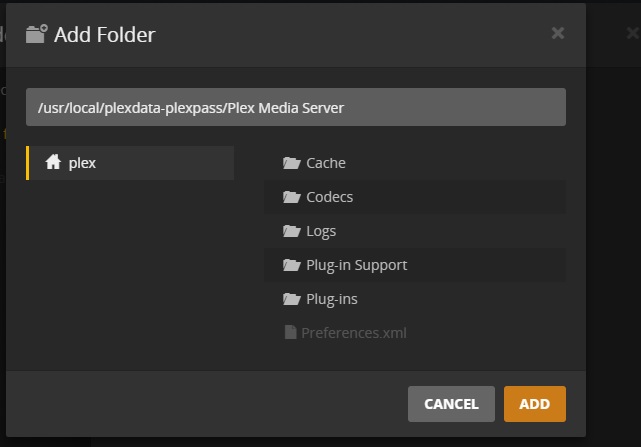

Before I get the hammer for creating yet another Plex thread, I will say that I have spent the last week reading articles on how to fix the problem I am having. I have been using FreeNAS for quite a while but I am not versed in Shell/CLI commands or how to use them. I have however been successful only once before in creating and installing Plex in a jail. I did this in 9.10 U3 and when it came time I updated to U4.
At this point my machine has been updated to FreeNAS 11 which, I believe is where the problem started. I have never had problems getting FreeNAS installed initially. It is obvious however that others have been able to make Plex see the mount points but I cannot. I am not sure why. I used the instructions for installing Plex in a jail that are located at the link below.
https://forums.freenas.org/index.ph...ombi-transmission-nzbget-sabnzbd-organizr.58/
Issue being that when I follow those instructions everything seems fine until I try to navigate to the mount points so Plex can see the content I have stored and populate all the appropriate categories. If someone could help me with this it would be appreciated. I have included a screen shot of the issue below and hope it will be obvious to someone else what the issues could be.
Thanks!

You need to type the mount point address into the light gray box at the top of the page.

Should have mentioned that I have tried that over and over and it never populates the content. Installations in the past (when it worked) would have the mount point available to browse below the gray box. Manually entering the mount point address does not have the desired effect of making said mount point available.

Having the mount point available to browse to "disappeared" a few updates ago. There are a thread or two on this forum discussing what worked when typing in the mount point didn't work. This never happened to me so I have no words of wisdom other than to suggest you search for "Plex can't find media" or similar. Good luck.

I had a similar problem. I solved it by adding the following storage settings to my Plex standard jail:
- Source: /mnt/mvol2/plexdata (‘mvol2/plexdata’ is the dataset where my media folders reside)
- Destination: /usr/local/plexdata/Plex Media Server/Media (‘Media’ folder will be created if it doesn’t exist)
- Create directory & Mounted? both checked
Now, when Adding a Library in Plex you will likely see ‘/usr/local/plexdata/Plex Media Server’ when you ‘Browse For Media Folder.’ You should see the ‘Media’ folder that was created above. Click on it to access your media folders.
Hopefully this will work for you. It did for me.

Thanks JoeIN,
The process you described worked for me. I was able to map to the media folder and then on to additional folders for the different types of media within said folder. This is exactly what I needed!
