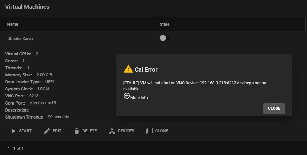

I thought I was home free but now I really need help: I made a clean install and uploaded the saved configuration. Then I deleted the old VM and proceeded to add a new VM only to end up with an error message: Now what?
Jul 2, 2019
648
From the part of the screen shot it appears that the BIOS virtualization settings are not enabled. From the docs make sure it is enabled:
TrueNAS VMs use the bhyve virtual machine software. This type of virtualization requires an Intel processor with Extended Page Tables (EPT) or an AMD processor with Rapid Virtualization Indexing (RVI) or Nested Page Tables (NPT). VMs cannot be created unless the host system supports these features.
To verify that an Intel processor has the required features, open the Shell and run grep VT-x /var/run/dmesg.boot. If the EPT and UG features are shown, this processor can be used with bhyve.
To verify that an AMD processor has the required features, open the Shell and run grep POPCNT /var/run/dmesg.boot. If the output shows the POPCNT feature, this processor can be used with bhyve. Note that AMD K10 “Kuma” processors include POPCNT but do not support NRIS, which is required for use with bhyve. Production of these processors ceased in 2012-2013.

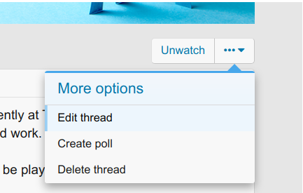

Jul 2, 2019
648
No problem: Go to the top of the thread and click the three dots, edit thread
Then on the title subject use the drop down to select Solved
