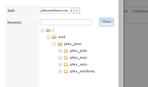

I am very new to this but really appreciate your help. I have attached a pic of setup from your question I think the answer would be no, but please review & let me know, Thanks

Without being able to compare to my machine, I would say that it looks like you DO NOT have storage set up for your jail. In order to do so, under "Storage" in the list on the left you would want to click "Add Storage" and follow the prompts. Then, enter your plugin configuration (Plex provides a web page for this, I believe) and set it up to look at the directory you provided for that storage.
In the end, what you'll be doing is mounting your freenas storage under a directory in your jail. You'll then access your freenas data from the jail through that directory.
It sounds a little wonky, but it makes more sense once you get in tune with what it's doing.

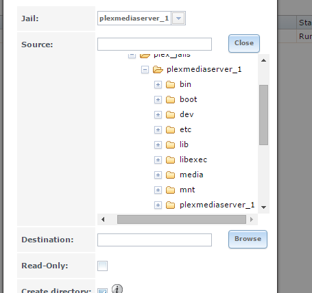

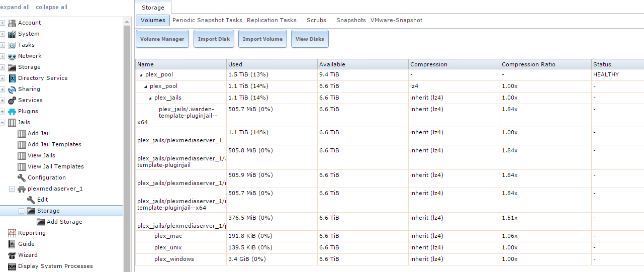

Matt - I went to add storage to the Jail for my Plexmediaserver_1 I cam across two sets of definitions & none of the folders/files of my old names I had used for them:
Looks like Plexmedia was reinstalled within its self????
If I need to I have no problem with wiping it all out & starting over with fresh install, but I would like to get a copy of all my media first as much of it can not be re-created. Thoughts, suggestions?

First of all your original plex jail is still there. A power outage will not delete a jail. So let's find your original jail. I suspect it is in your root dataset and not the plex_jail dataset. Did you just create that dataset? What is the output of zfs list? Make sure to use code tags when providing information like that.

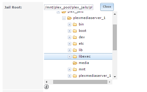

Yes, so it looks like your current jail root directory is inside your original Plex jail. What happens if you make your jail root /mnt/plex_pool/plex_jail ? This should make your original jail appear in the GUI.

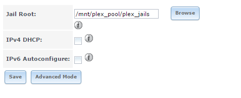

I was able to update the Jail Root:
Once I rebooted the server I then was able to get the Jail to change from STOPPED to RUNNING status

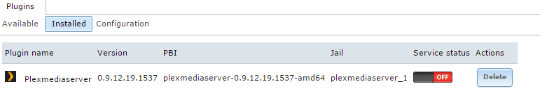

But the Plugin is not in a OFF service status, I tried to switch it to ON, but it will not go & it does not display any error message at the top of screen when I do it either.
Next step?
