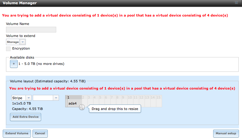

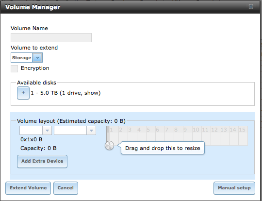

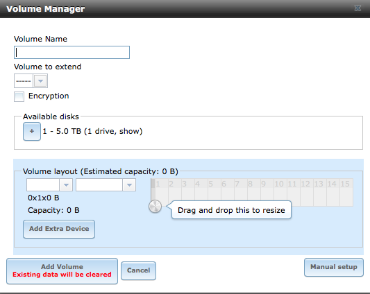

Right, I've done the "Volume to Extend"... Selected "Storage" (As it's my only volume)... but after running, nothing happens. If I select the added drive, I get error:
  • You are trying to add a virtual device consisting of 1 device(s) in a pool that has a virtual device consisting of 4 device(s)
Here are screenshots...

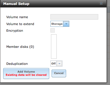

Yeah, they've added some overzealous warning messages in an attempt to stop people from doing stupid things (usually striping in a single disk with a RAIDZn pool). You'll need to use the Manual Setup button to accomplish this.
Hmm, that's a bug. There are four vdevs of one drive each (unless you somehow have 20TB HDDs, which I doubt).
https://bugs.freenas.org/issues/25721

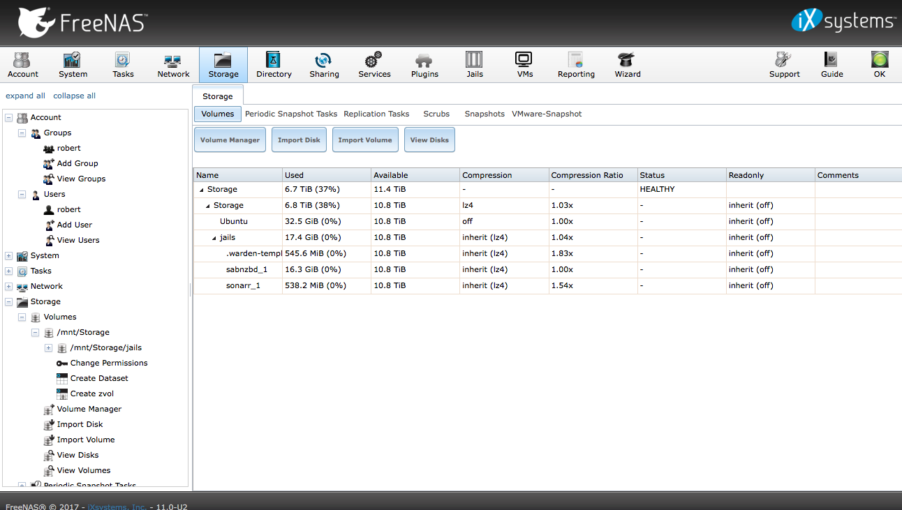

OK... SO!!! Manual setup was the way to go... There is an additional bug... There is a warning that on the extend, all data will be lost (it won't)...
Thanks guys... looks like I could have stumbled through this and figured it out... just a lot of warnings that weren't pertinent...
Screen shot is after the drive was added... sorry, I didn't take a shot before I pulled the trigger... Again, the warning is a false warning... Data remains after attaching the 5th drive...
Any data on the disk(s) you're adding will be lost. Data on the pool you're extending is, as you note, unaffected.
Jun 24, 2017
338
AH! So, the warning is for the disk that is being added, not the disks that already exist... gotcha... makes WAY more sense now.
