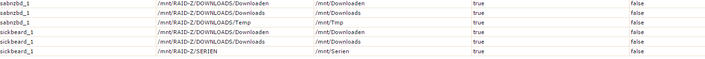

And another Question.. The Plugins can now create Folders, ... but Sickbeard gives me the follow Errors:

2015-01-11 14:17:59 CP Server Thread-3 :: Unable to create the folder /mnt/Serien/Warehouse 13, can't add the show
He can't create Data...

This is when SickBeard is trying to send stuff to sab, or during post-processing? Are you using sabnzb'd api or having sickbeard drop nzb's somewhere?
What is your directory structure of downloads and media in the jail.
Everything works perfectly for me, always, but I have a single dataset for both my downloads and media owned by user 'media' mounted in my jail.
Joshua Parker Ruehlig
Dec 5, 2011
5,949
Sickbeard save the NZB's in the Folder Serien...
you could just the API method and have sickbeard directly tell sabnzbd what to download. This is more efficient cause sabnzbd doesnt need to be scanning the Watched folder.
Also, I personally recommend having your completed downloads and final media locations on the same dataset, mounted into the jail(s) using a single mountpoint. Otherwise Sickbeard has to do a read-write-delete operation instead of just moving the file within the same dataset (which is just changing some reference blocks).
