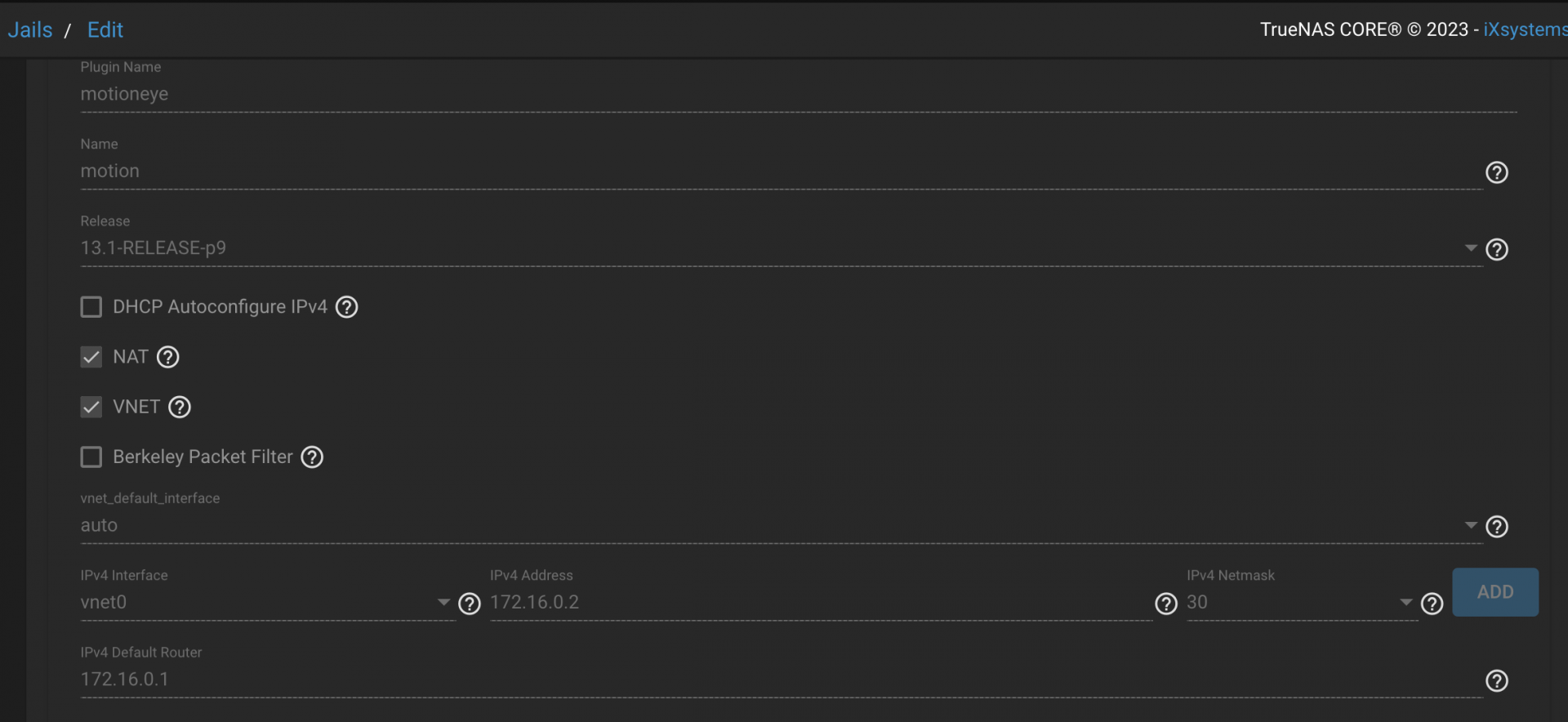

Hello,
I've installed the plugin motion to get records from my cameras. The installation went well.
When I tried to get the URL http://192.168.1.19:8765, I got connection refused.
I went into the jail and tried a telnet which is ko.
I tried with the port 80 and it works. See below:
root@motion:~ # telnet localhost 8765
Trying ::1...
telnet: connect to address ::1: Connection refused
Trying 127.0.0.1...
telnet: connect to address 127.0.0.1: Connection refused
telnet: Unable to connect to remote host
root@motion:~ # telnet 192.168.1.19 8765
Trying 192.168.1.19...
telnet: connect to address 192.168.1.19: Connection refused
My conf for the jail:
Many thanks

I don't have experience with the motioneye plugin, but I am going to assume that the maintainer has stopped maintaining it. Reason being that IXSystems have decided that plugins are going away.
There is another service (Zoneminder) that is linked to in my signature. It has an install script that installs it into a jail and is better to maintain as it doesn't rely on the TrueNAS plugins to be updated.
rjcb
Jun 19, 2023
12
Thanks for you reply. 2 months ago it worked well and since my fesh install I am facing this issue :(
