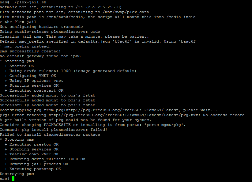

Just doesn't want to work, I think where it fails is that I have a LAGG port that attaches directly to vlans and nothing physical.
What I need to be able to do is change the bridge setting in the jail before it boots to represent the VLAN it resides on, anything to work around this as all it does is fail

When you say nothing physical you mean no native VLAN?
I think you’re right that the script will struggle in this case. You can manually add that to the relevant line that creates the jail, for now. I think it’s the vnet_default_interface you need, but you’d know this in more detail, since you’ve set up jails on VLANs and I haven’t.

Yea, I saw that option and changed it to reflect the correct VLAN bridge (vnet0:bridge15) and it threw another error. It does have a native lan (1) but as as a security thing I disabled it as I don't need it running for things to work. There has to be a fix and it has to be something as simple as what you suggest but alas I am at a loss.
I've dropped a issue on Dan's github, guess I'm just gonna have to wait to see if there is a fix as I use DHCP on my VLAN via pfSense so need it pfSense to assign IP's before setting static as I prefer to control all IP addresses from pfSense.

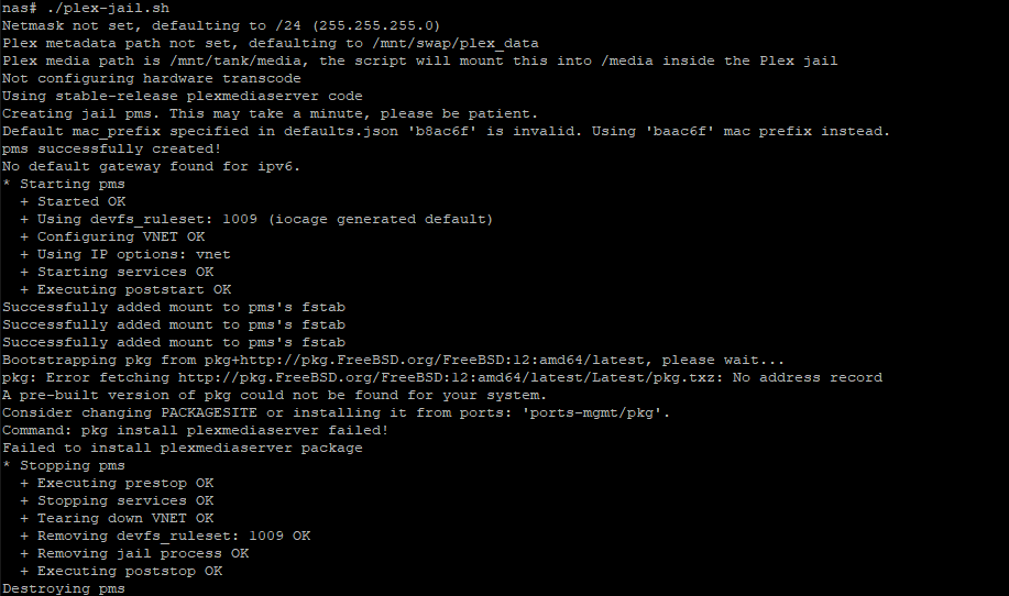

Just tried with the native LAGG active and still it refuses to work!
