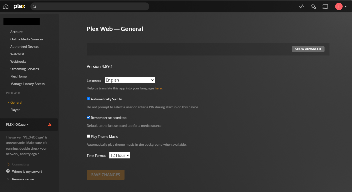

I have logged into http://<IP of your Plex server>:32400/web using my Plex login with the updated password and what below is all I see. I dont see any option to claim the server as an authorized device. I have restarted the jail a few times but no change. Plex was working perfectly this morning right up until I changed the password and clicked Sign Out of connected devices.

Click on authorized devices to remove your server. Also click Remove server under PLEX-iOCage. Restart the jail, and login to http://<IP of your Plex server>:32400/web again.

Okay Strange enough, I have been logging in through Chrome and no luck but I tried Edge and now I was presented with the Claim Server option which was not being shown to me in Chrome. Not idea why but it worked and I am connected back to the server now.
