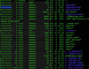

small update. i have SSH into the console as the root user. As you can see by the screen shot the permissions are all out of wack. I am trying to write to the User_Backups folder but am unable to. I have tried various chmod commands but can't seem to crack. any ideas how to grant "drwxrwxrwx" to all folders in directory?

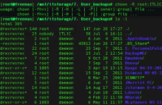

Weird. chown -R root:ITLIC on your User_Backups directory and do an ls -l again to see if it took.

i ran the chown command in the folder that i want to grant access but it didn't do anything. look at screen shot. am i missing something?
Ideally i want to grant everyone access to the parent folder which falls under "/mnt/itstorage"

Looks like the command wasn't executed properly (or the jpg is truncating the right side of the screen).
try this...
cd /mnt/itstorage
chown -R root:ITLIC 7.\ User_Backups
chmod 777 7.\ User_Backups

i ran "chmod -R 770 "foldernamehere" and I was able to RWX to the folder including all the other folders.
Monday will be the real test.
I will keep you updated. thanks so much.
