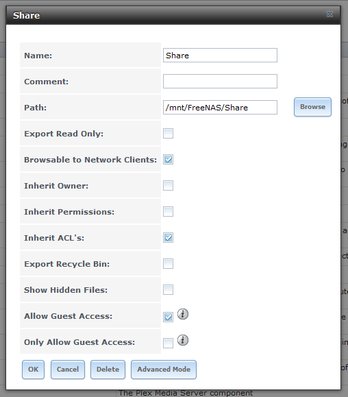

The CIF Share setting are below.

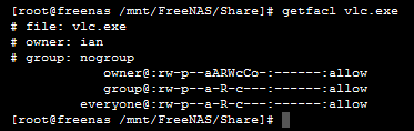

Here is a getfacl shot of a newly created file.

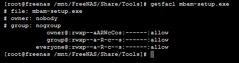

I notice that the file is not executable. However, below is that of a file created on the Share by a computer NOT logged in and has been created as the 'nobody' user.
It seems to have the correct permissions. So somewhere along the way I have setup my 'ian' account up wrong. But I can't see it.
I may have had issues with inheritance when first setting it up. I notice my 'Inherit Permissions' is not checked in the CIF share settings, is this meant to be checked?

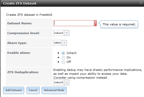

There is an option when creating a ZFS Dataset labelled 'Share type'. I do not recall this being there when I first installed FreeNAS 9.0, and hence when all my Datasets where first created.
All my datasets are set to UNIX.
So I created a 'Test' Dataset and set it to UNIX. Same issue.
I then created a 'Test2' Dataset and set it to WINDOWS. Now the permissions works perfectly.
Now this seems obvious you say. But I really do not recall that 'Share type' option being there. Is it new or have I just missed it? (Just looking through the FreeNAS documents and came across this screenshot. So doesn't look like it used to be there.)
New question, using the GUI it doesn't seem possible to switch the 'Share type' to WINDOWS. Is there a way to switch them without deleting the whole dataset?

Share type has always been there. I can't answer your switch question. Try searching forums. I'm newbie in FreeNas, but have many years of experience in Unix.

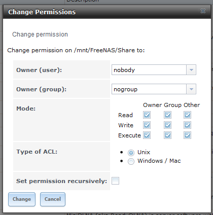

You're right. Although the 'Share type' option wasn't there. The 'Type of ACL' option was elsewhere. I had it selected to Unix because I had read somewhere that said only use Windows if I used active directory, which I don't. I must have misread.
Yes, have been able to change the datasets now.
