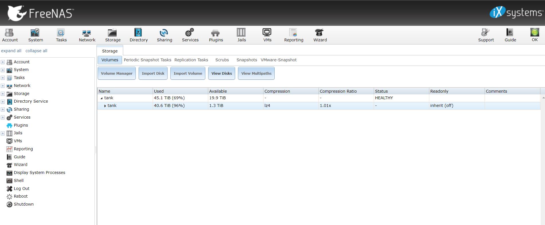

Hello, I'm hoping to get some advice on how to properly configure the volumes on two new freeNAS devices. We always receive our NASes with a pre-configured volume setup, see attached. We prefer RaidZ2, and I've recently read that you want your vdevs to have a number of drives equal to a power of two, but not exceeding 9. So, my thought is, if we are going with RaidZ2, we should have 4 drives per vdev, 2 vdevs on the 12 drive setup and 4 vdevs on the 24 drive setup. Any Ideas?
PS. These are going to be using iSCSI and Veeam.
