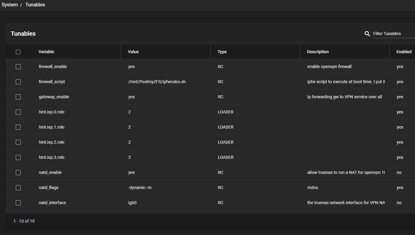

After some testing, I determined that the problem was caused by the tunables entries I had made to support OpenVPN. I disabled all of them then re-started Truenas. I no longer get the Nextcloud message, and pkg update / pkg upgrade works.
I need to do further testing to see if there is one specific tunable entry causing this, but thought I'd reach out to see if others have run into the same issue. If so, how did you resolve it?
