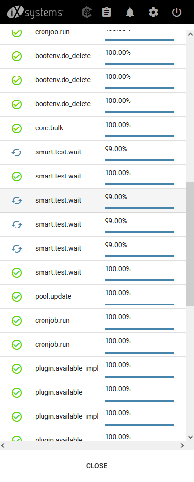

  6. This takes us to the present day: the system is running fine but i have 4 smart tests i started 2 days ago stuck on 99% and this message
Jun 12 05:58:01 freenas APEI Corrected Memory Error:
Jun 12 05:58:01 freenas Node: 0
Jun 12 05:58:01 freenas Device: 1
Jun 12 05:58:01 freenas Memory Error Type: 2
Jun 12 05:58:01 freenas Flags: 0x1
Jun 12 05:58:01 freenas FRU Text: CorrectedErr
My system specs are as follow:
-E3C224D4I-14S
-32 GB ECC DDR3 Kingston memory
-4x3TB WD RED+2x4TB WD RED (1 pool)
-Intel(R) Xeon(R) CPU E3-1231 v3
Let me know if anyone has any idea of what is happening and if i can upload anything else to help in the process.
Cheers,
Mike
Samuel Tai
Apr 24, 2020
5,399
What are the exact models of your Reds? If they’re WD40EFAX, then you have SMR drives, which can explain the behavior you’re seeing.

This looks like a RAM error
That is also what i initially thought after some googling. I'm not sure how to approach it...
