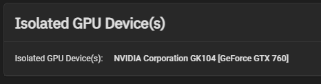

The GPU is set as isolated in the options:
The GPU is then selected in the options of the VM:
I have tried several options, "Hide from MSR" - checked/unchecked, isolating the GPU and not isolating, adding the GPU manually through devices as PCI passthrough device. The GPU itself is recognised in the Windows VM, but the driver is not loaded. I get the (infamous) Error Code 43.

Nvidia blacklist certain GPU's for use in a VM. You'll have to get a GTX 1xxx series or newer if you want to pass one through to a VM.
whodat
Apr 28, 2018
34
@zubo100 I also tried for a long time to get my GTX 760 working, with the same results as you.
I then logged a support ticket with iX Systems, and was told it is unsupported on TrueNAS SCALE:
I bought a 2nd hand GTX 1660 instead which works perfectly (especially after applying the keylase patch to unlock the concurrent stream limit)
