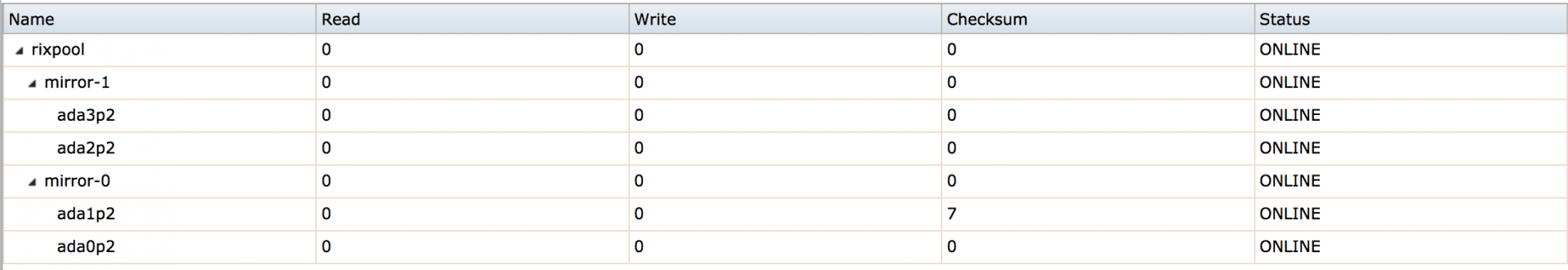

Here's what I found. Looks like a checksum error on ADA1.

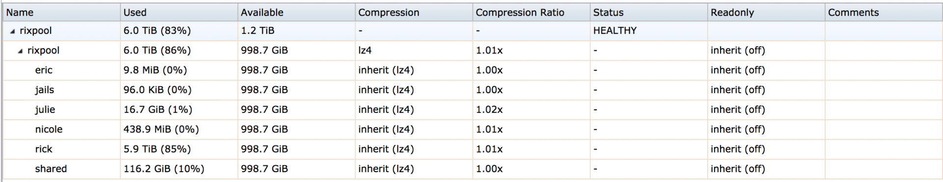

Expanding "rixpool"

So good was the help that I think it shows I have mis configured my 4 users under 1 volume, when in your array I think you have a separate volume for each user of the server (correct me if I'm wrong). I will work on changing this (if this is in-fact true) after I get the array hardware back to correct operational status.
No, those are not users. I have different pools for different storage needs, I just named them after people for personal reasons. In my configuration, the main storage is the Emily pool and all users have access to that. The Irene pool is a full copy of everything in the Emily pool but nobody can access it except me, from the command line, because it is not shared to the network. The Backup pool is another backup of what is in the Emily pool but it is shared to the network in read only mode so that users can fix their own mistakes without needing to bother me over accidental deletion or similar mishap.
There is nothing wrong with the way your system is configured and I am not advising you to change it. Except that you might want a spare disk, especially since the ones you have are getting a little older. I try to replace my disks around the five year mark, or earlier if they fail on me.
