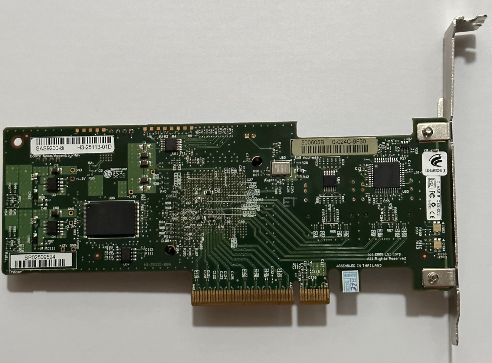

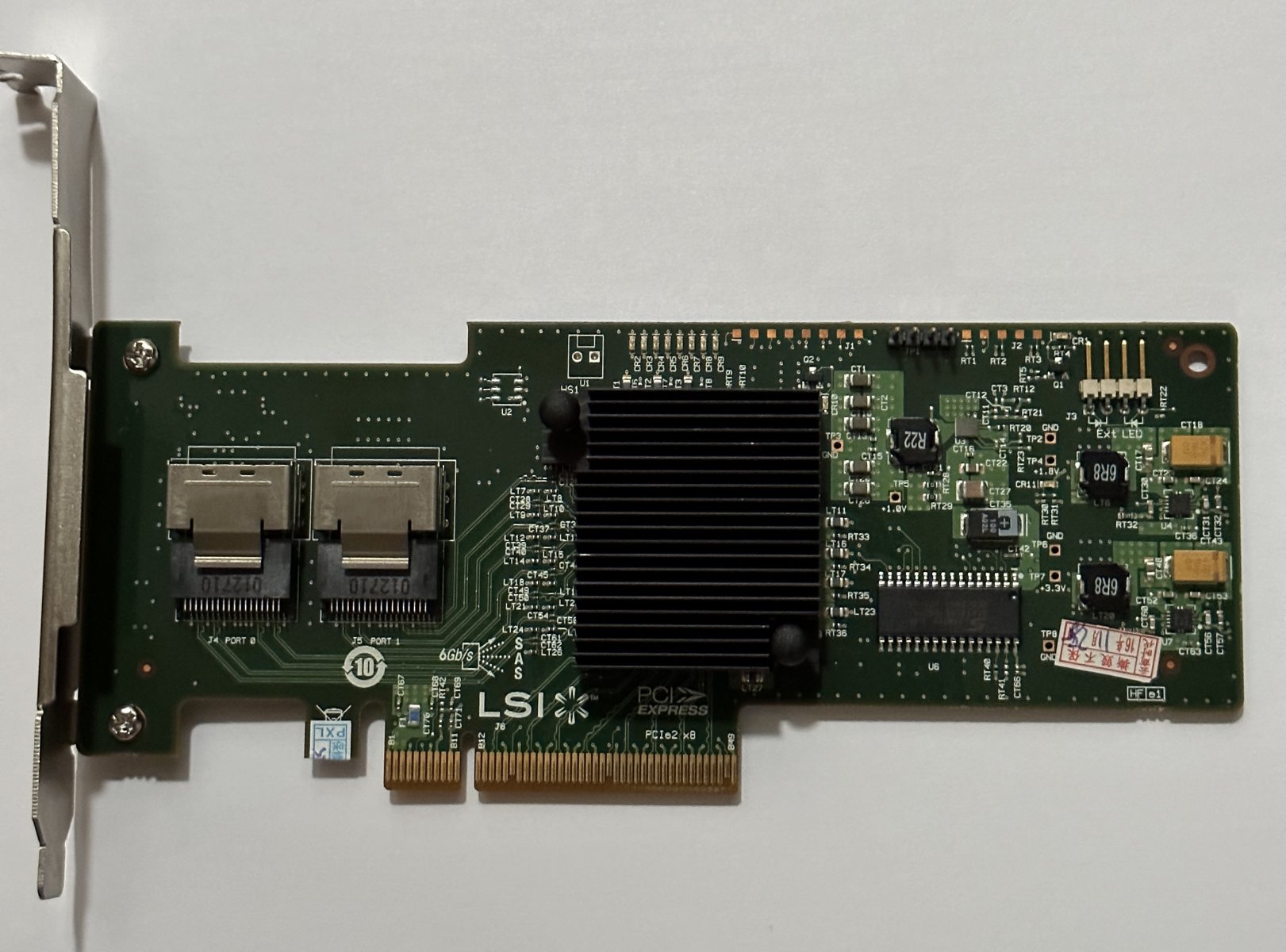

Solid cover. Here are some photos.

The Chinese stickers are also rather dodgy.
I watched The Art of Server and while mine looks genuine, I question it because it had a foil sticker over the LSI logo on the front. Not sure why...and of course now I'm paranoid I got some cheap knockoff with no real way to tell. According to the video, mine is supposed to be genuine.
It has a few things fakes like to avoid, like the LSI logos. But I guess it could be a grey-market factory reject, which would explain some functional issues.
