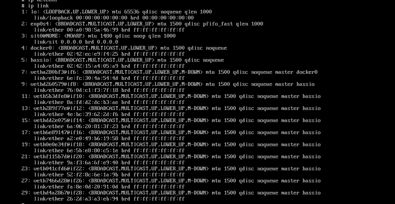

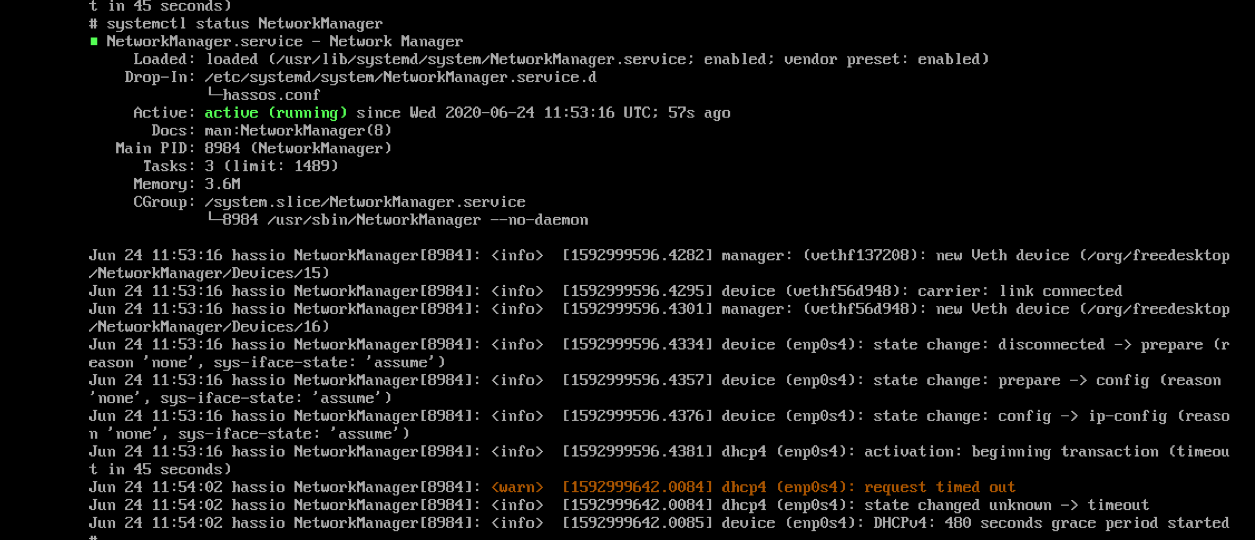

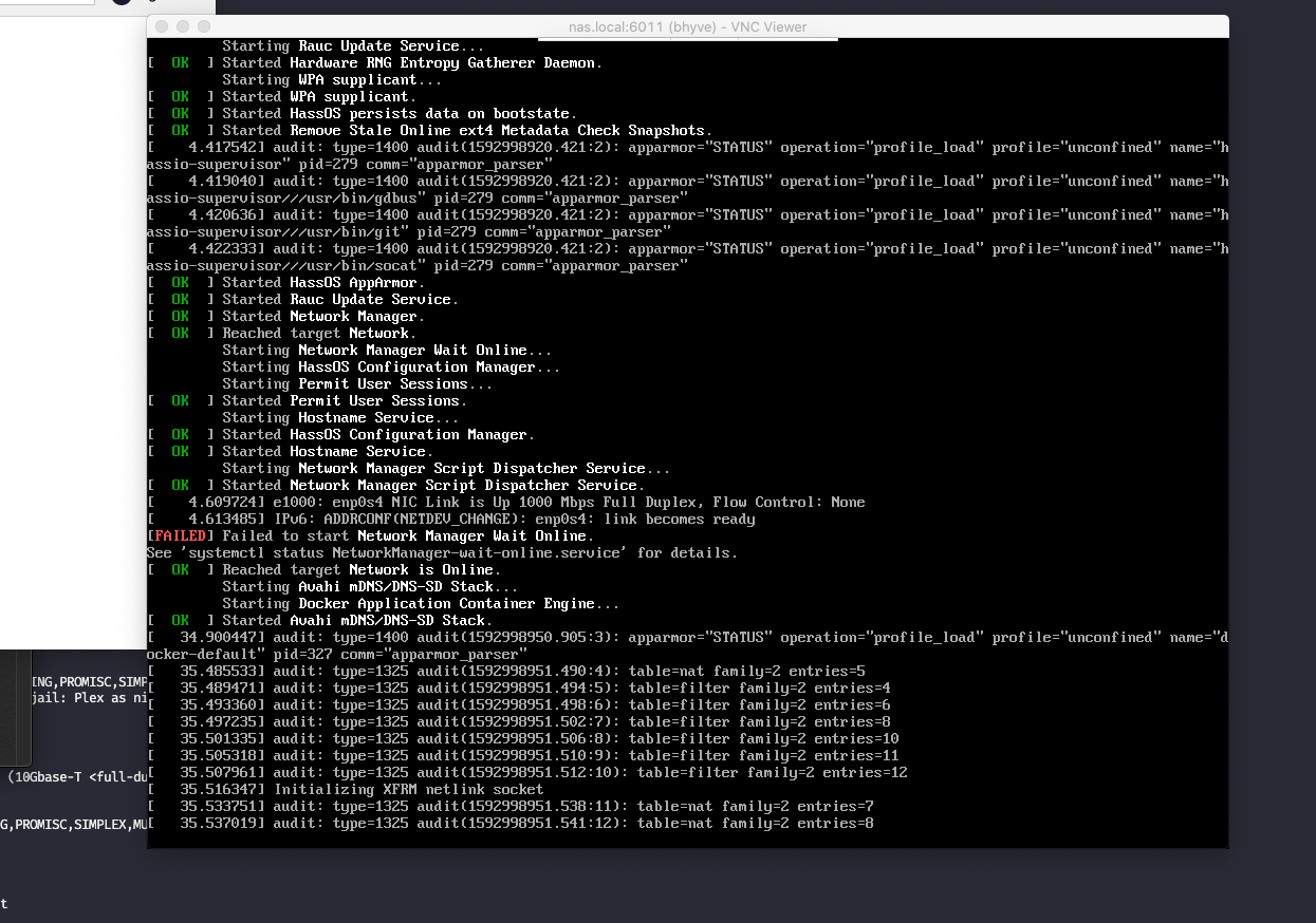

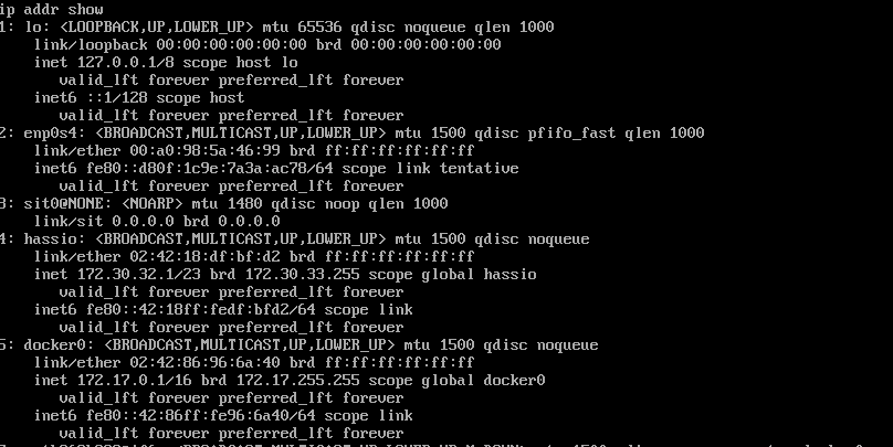

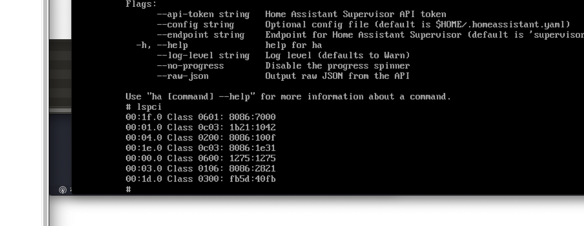

I'm currently trying to passthrough my USB3.0 PCI Hub to my HASSio VM to finally connect the Zigbee stick directly to HomeAssistant. I did some searching around on how to do that and got something that kind of works together. The big problem here is, that hassio can't connect to the network if I start the VM via the CLI (as root user). If I start the VM via the UI it works just fine though. The PCI passthrough is working fine and I can connect to the machine via VNC and interact normally, except no network connection.

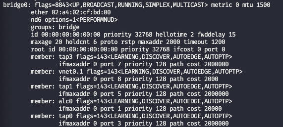

I saw in the logs that a NIC_ATTACH was happening:
So i was wondering, whether and how I need to do that if I start the VM from the cli. My other guess would be that the UI uses a different user to start the VMs. If I knew that user I could try starting the VM with it and see if something changes.
It would also be super helpful to know, whether I can adjust the command that is used to start the VM via the UI, maybe I can just inject my snippet there and see if that works.

- If I connect to the hassio install via vnc I can see connected USB devices (to that PCI adapter) via the hardware info.
[2020/06/23 17:57:54] (DEBUG) VMService.vm_6.run():179 - ====> NIC_ATTACH: alc0 [2020/06/23 17:57:54] (DEBUG) VMService.vm_6.run():293 - Starting bhyve: bhyve -A -H -w -c 2 -m 1300 -s 0:0,hostbridge -s 31,lpc -l com1,/dev/nmdm6A -l bootrom,/usr/local/share/uefi-firmware/BHYVE_UEFI.fd -s 29,fbuf,vncserver,tcp=192.168.x.x:6011,w=1024,h=768,, -s 30,xhci,tablet -s 4,e1000,tap3,mac=00:a0:98:5a:xx:xx -s 3:0,ahci,hd:/dev/zvol/hassio/system 6_HassIO
