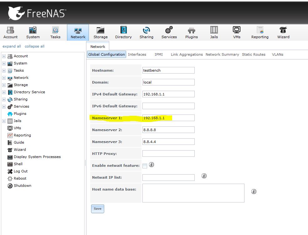

I read of a work around for this...
IIRC you must use the router's IP (on my case 192.168.1.1) as the first DNS server listed, if you have DNS servers such as 8.8.8.8(Google) and other websites
When your internet goes down they can't be used because they are WAN IPs. Set your "first" DNS address as your router's IP and see if this makes a difference.

Actually this is the way I already had the network configured in FreeNAS. It didn't make a difference, and I'm not sure I even understand the rationale behind this. If FreeNAS is looking for a DNS server and DNS resolution, it couldn't find one in my router because I don't have a DNS server. Having my router's IP listed as the first DNS simply means FreeNAS would look there and find nothing, since all the router does is pass through DNS requests to whatever real DNS servers it is configured with.
I guess I'm just going to have to conclude this is a bug in FreeNAS, very possibly in the underlying FreeBSD code, and hope that it goes away with a future release....
