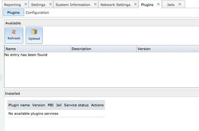

Hello. New FreeNAS 9 RC2 install. Upon installing I went to Plugins and saw the list of three plugins that were available (Transmission, the DLNA server, and the music server). I selected Transmission and it started to install. The progress bar hung at 20% and wouldn't continue, so after 10 minutes or so I clicked the "X" on the progress dialog. Now when I go back to plugins, it shows none in the list, saying "No entry has been found."
The Collection URL on the Configuration tab hasn't changed (it's still http://test-cafe.ixsystems.com/freenas/json and I can get to it in a web browser).
In "Jails," it seems to have created a "bit1" jail with its own IP address. If I go to that IP in a browser I get the standard "It works" page, but if I go to that IP:9091/transmission/web it fails with a browser error saying it can't connect to that port. I deleted the Jail but the list of plugins will not come back. I've pressed "Refresh" many times.
What might I be doing wrong here?

Please create a ticket at support.freenas.org so the devs can see if they can recreate this error. Also, is the FreeNAS system using DHCP or a static IP address?

for me i put
Network -> Global Configuration
nameserver1 8.8.8.8
nameserver1 8.8.4.4​
underpickled
Oct 1, 2013
167
for me i put
Network -> Global Configuration ​
nameserver1 8.8.8.8​
This worked for me too. Also, it fixed the "host not found" error I kept receiving for the ntp servers.

What worked for me:
1) Changed nameservers as above.
2) Also in
Network -> Global Configuration​
I put in my default gateway IP address (address of my router)​
3) I put www before the appcafe domain name in the address. i.e. http://WWW.appcafe.org/freenas/json
4) Refreshed the plugins page a few times and VOILA!

I'm glad I came across this thread, because this solution has worked for me too!
Used same settings as ryanf.
