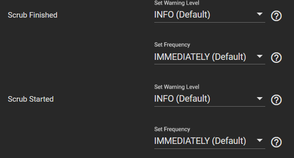

I'm currently running TrueNAS-13.0-U4 and I recently removed the legacy encryption from my pool. Around the same time I had some stability issues that I had to sort out first. The process of removing encryption involved exporting and importing my pool and apparently this reset my biweekly scrub to once every 35 days. No worries, those settings I can change. Somewhere I noticed that I did not get an email after a manually started scrub had finished. And now that my scheduled scrub finished this night I also noticed only getting an email about starting it, but not about finishing it.
I checked my alert settings and those still look good:

Under System -> Alert Services, what do you have set as the Level for your email service?

Well, for my finished scheduled scrub I didn't get an email. But I did see an alert under the bell. I cleared all alerts so that I can clearly tell which new alerts get generated next time.
