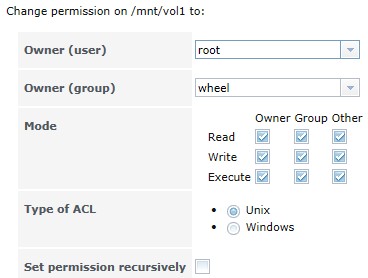

I have the ZFS volume with the below permissions. I have tried checking off the recursive option.

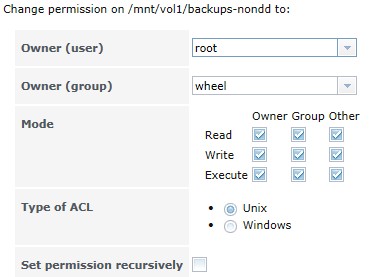

I created a dataset on the volume with the below permissions. I have tried checking off the recursive option.

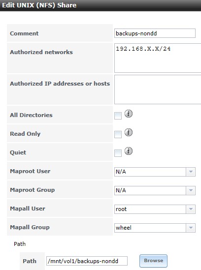

The NFS share is configured as below. Was hoping that using mapall as root would avoid conflicting user name/permission problems. We'll come back to permissions once we proove the concept.
And I have the option for the NFS service checked to allow non root mount.
