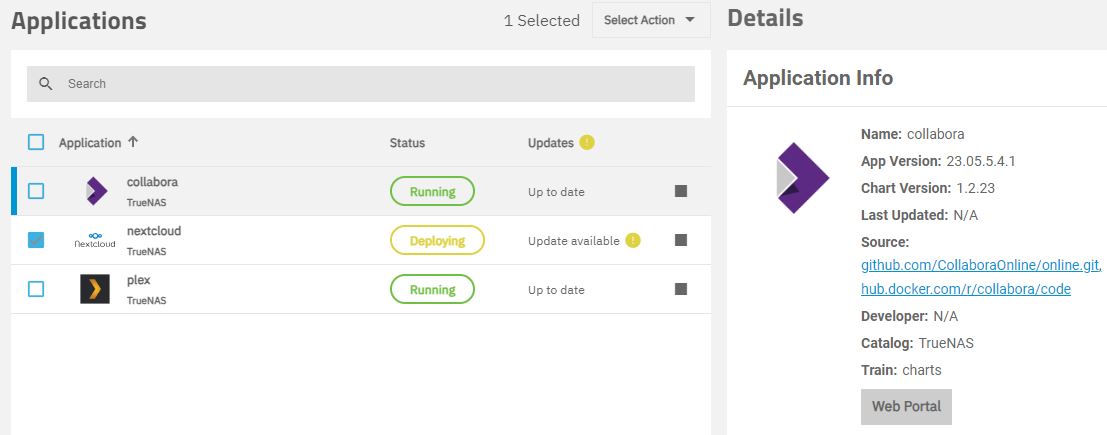

I have been very frustrated lately since the latest Scale 23.10.0.1 update. I had Nextcloud (Truenas nor Truecharts) running just fine for the last 3 months and even into the latest Truenas 23.10.0 update. I have two separate premise locations running Truenas Scale with Nextcloud (Truenas editions) running, Church and Home. The Church location has been updated with the latest 23.10.0.1 update and Nextcloud is still running ok. Both Nextcloud installs are limited to local use only and not served outside their local networks. The events that led up to my issue here on this server (Home) was that I wanted to try Collabora/OpenOffice. I was able to log into Nextcloud and began installing Nextcloud Office app. It was at that point Nextcloud froze for reasons still unknown. I could not break from it. I re-started Nextcloud app and that is when it would not re-deploy. Re-started Truenas and still same problem. My only guess was a corrupt file. Not knowing exactly where to look for or even what to look for a possible corruption, I decided to just remove Nextcloud and re-install and along with removing the old Nextcloud datasets for config and data, creat new and start over. Even with new datasets, Nextcloud is now stuck on deploying. During app deployment, both datasets, config and data, both show files have been added, but still no deployment. Any suggestions at this point?

Update: I gave another try and Nextcloud finally deployed. Still unknown what file was corrupted, but the app is up and running again. After properly deleting and creating new datasets (deleting old config files in each) the app is running once again. Thanks for your views and this thread can be resolved.

I don't think I will be trying Collabora anytime soon again, but my Nextcloud is back and I am leaving it as is. Before the latest major update, I was not able to get Truenas chart release or Truecharts release of Collabora to install as it would be stuck on deploying. However, after the 23.10 update, Collabora did install perfectly. At that point is when I ran into my Nextcloud issue. Not sure what underlying issues I may have on my server up to this point.
The only other issue I have had, possibly regarding the 23.10 update, was Adguard just quit working. I have a TN replication server with 23.10 update running Adguard (the only app installed) without issue.
Please someone reading this thread correct me if I am giving the wrong suggestion, but the best thing I could recommend for you would be to create a couple of temporyary datasets for your Data and Config files, point to those datasets in Nextcloud to see if it deploys. If it does, it would seem that one or more config files have been corrupted.
