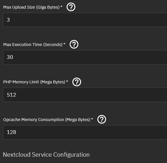

Update: I just updated the Nextcloud app to version 27.0.1_1.6.37.
The installer window now explicitly refers to Max Upload Size variable.
Thanks very much to the TrueNAS team for having made this field available!

tried to sync photos and videos from my Iphone to nextcould.
Lager mov-files were transfrred only partly from iphone to the nextcloud.
nextcloud 28.0.2_1.6.57
TrueNAS-22.12.3.3
Max upload size is set to 3 GB.
Mov-files far below that threshold were not transfeerred completly.
Is there another setting for sync with the nextcloud app under IOS?
Or another solution?
