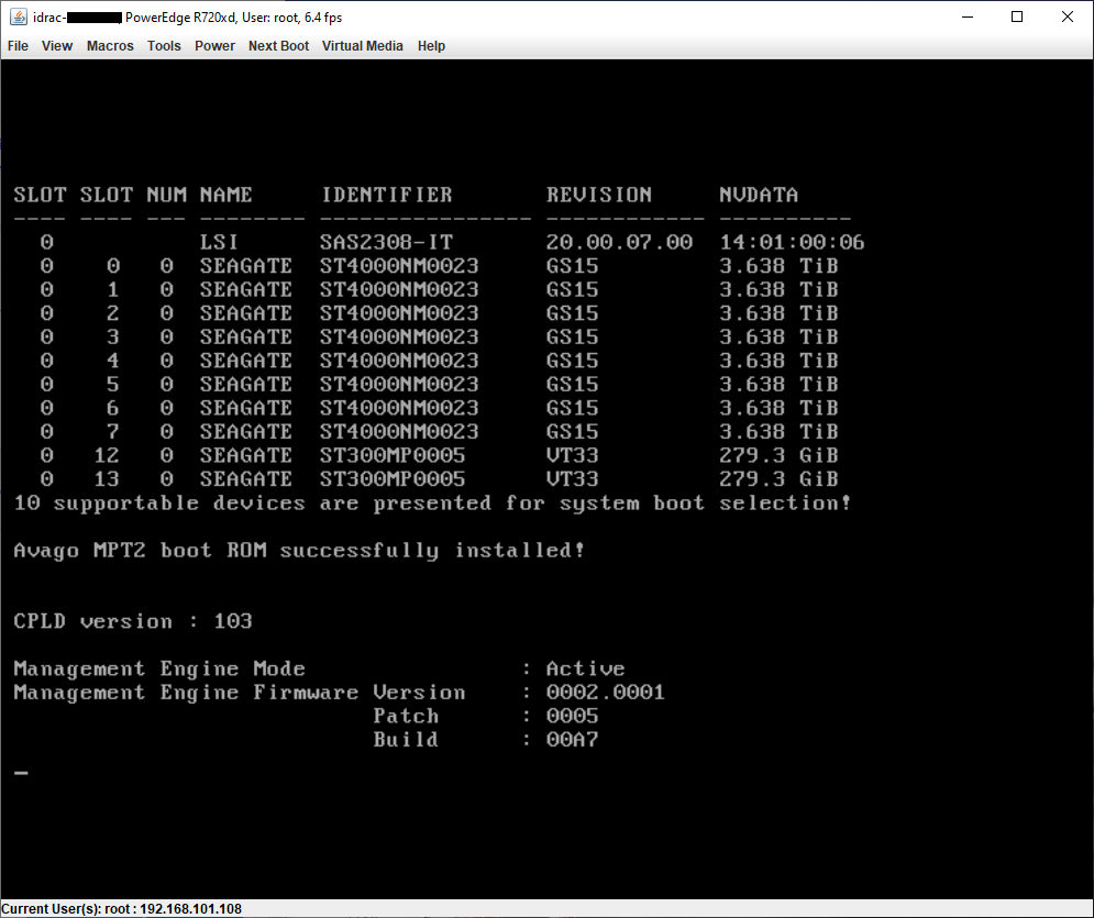

If I Press Ctrl-C when booting to view the attached disks, all 10 disks are shown.
I've tried installing TrueNAS onto both 300GB Drives shown at the bottom of the list in the attached image:
I'm using a Dell R720xd server.

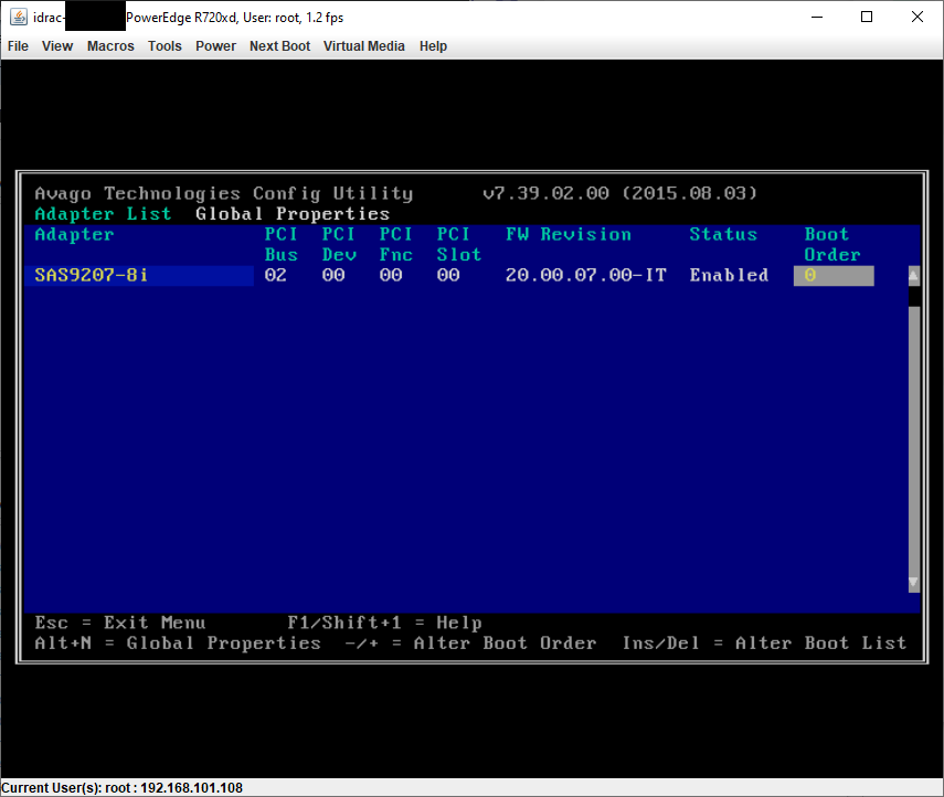

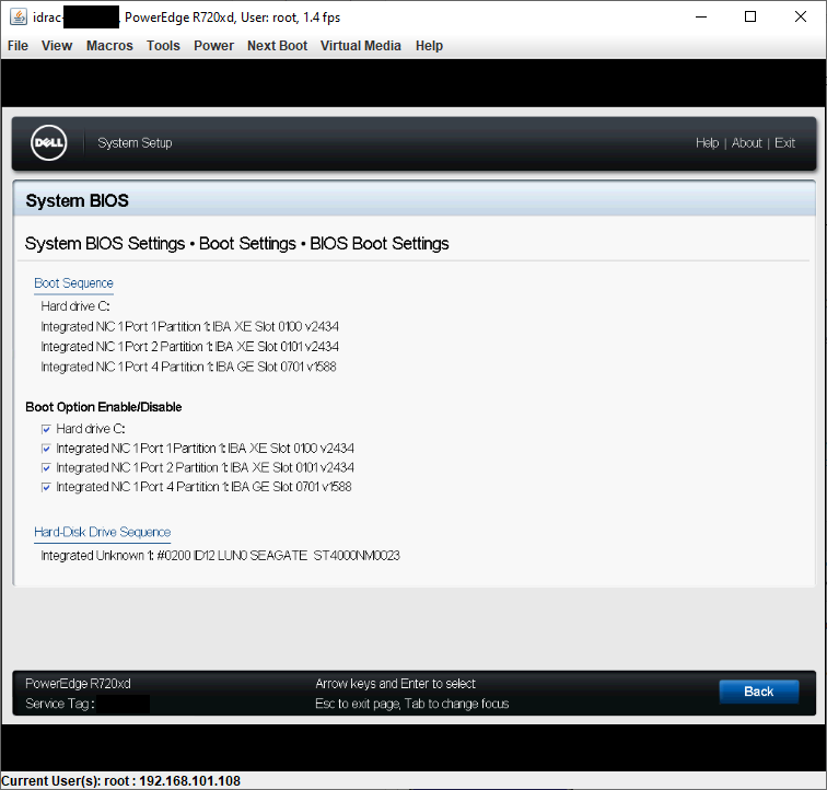

@HoneyBadger I can't force a boot using F11. I don't know how to set the rear drives as bootable in BIOS?
I've gone into the setup utility on boot by pressing Ctrl-C and I get the attached screen:
There are only 3 options and only 1 adapter to select from so I can't change anything in here.
When I boot into BIOS and view the Boot Settings, I can only see a "Hard Drive C:" and 3 NIC Cards:
Selecting the Hard Drive gives me just one of teh 10 installed drives listed.
Can you choose to put your boot disks at the top in the Hard-Disk Drive Sequence section?

You'll have to change the boot device In the LSI BIOS itself (Ins/Del) as right now it's using LUN0 which is the first 4TB Seagate ES.3 in bay 0 (you can see in the Dell BIOS)
This video from ArtOfServer seems to go through the process in all of the steps - although it's a little lengthy. I don't have something in front of me I can screenshot right now unfortunately.
Sc0ttJM
Sep 2, 2021
7
@HoneyBadger you're my new favourite type of badger!
This worked perfectly, thanks so much, I would never have worked that out, the utility doesn't even show the Alt-B and Alt-A options in the menu at the bottom. Now for the fun bit, I can start playing with TrueNAS.
