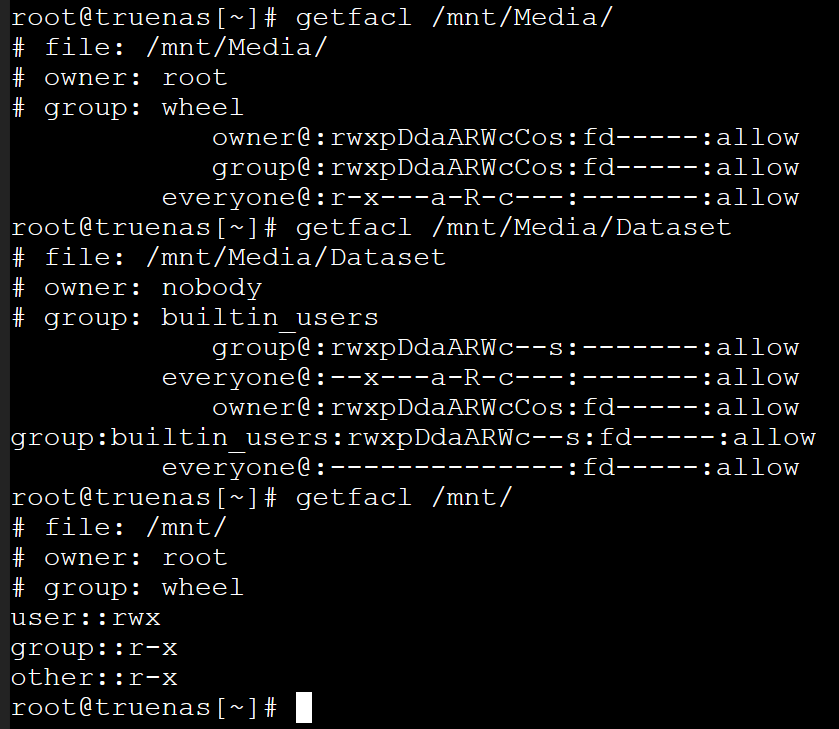

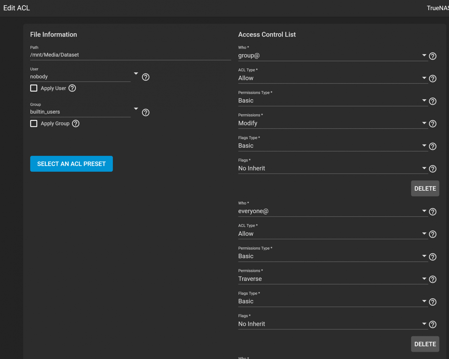

Hello all,

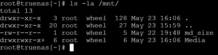

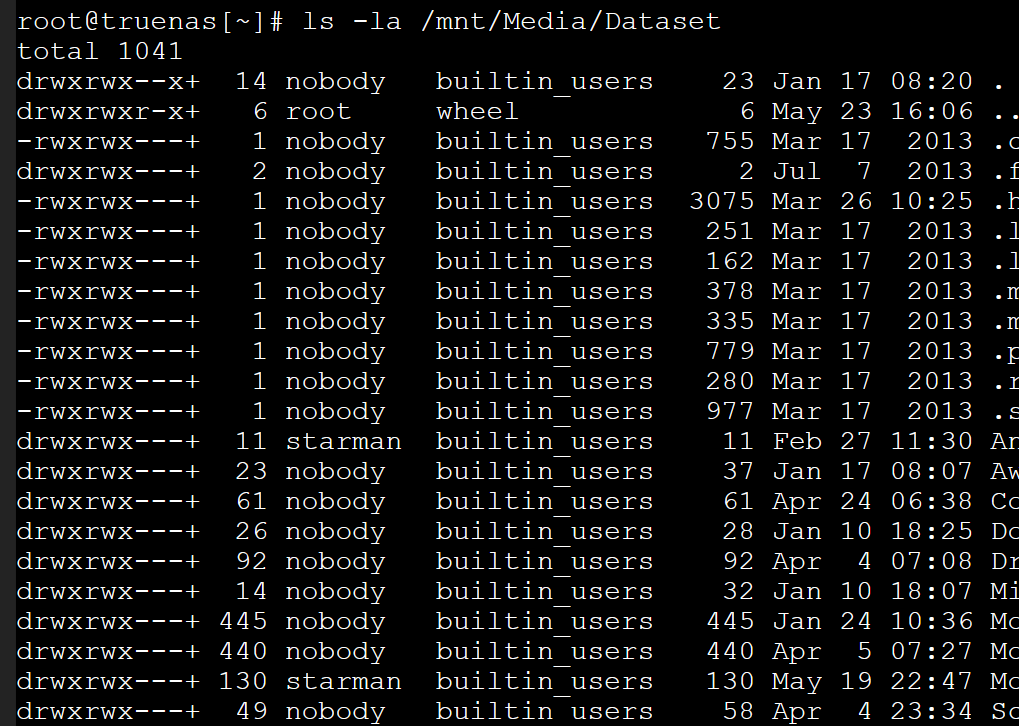

Suspect this is a permission issue but I am unsure.
I have recently built new hardware to move from Freenas 9.3 with an existing pool onto new hardware, upgrade to TrueNAS [TrueNAS-12.0-U3.1] and import existing pool. The hardware build, install, basic setup and importation of existing pool all completed without issue [feature flag upgrade outstanding pending system stability confirmation].

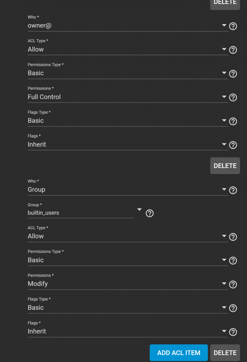

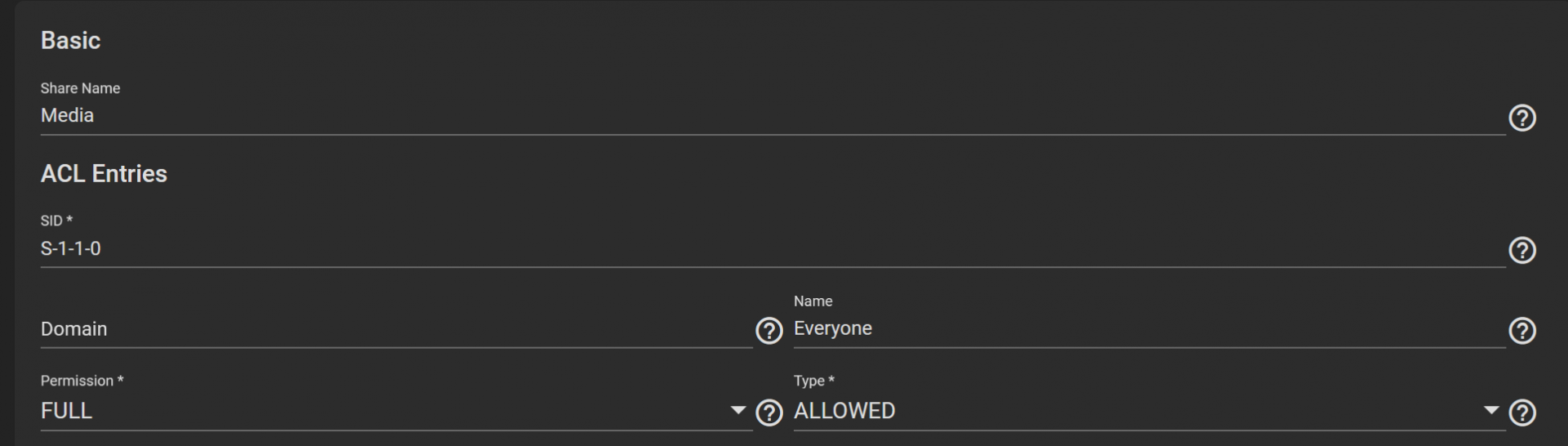

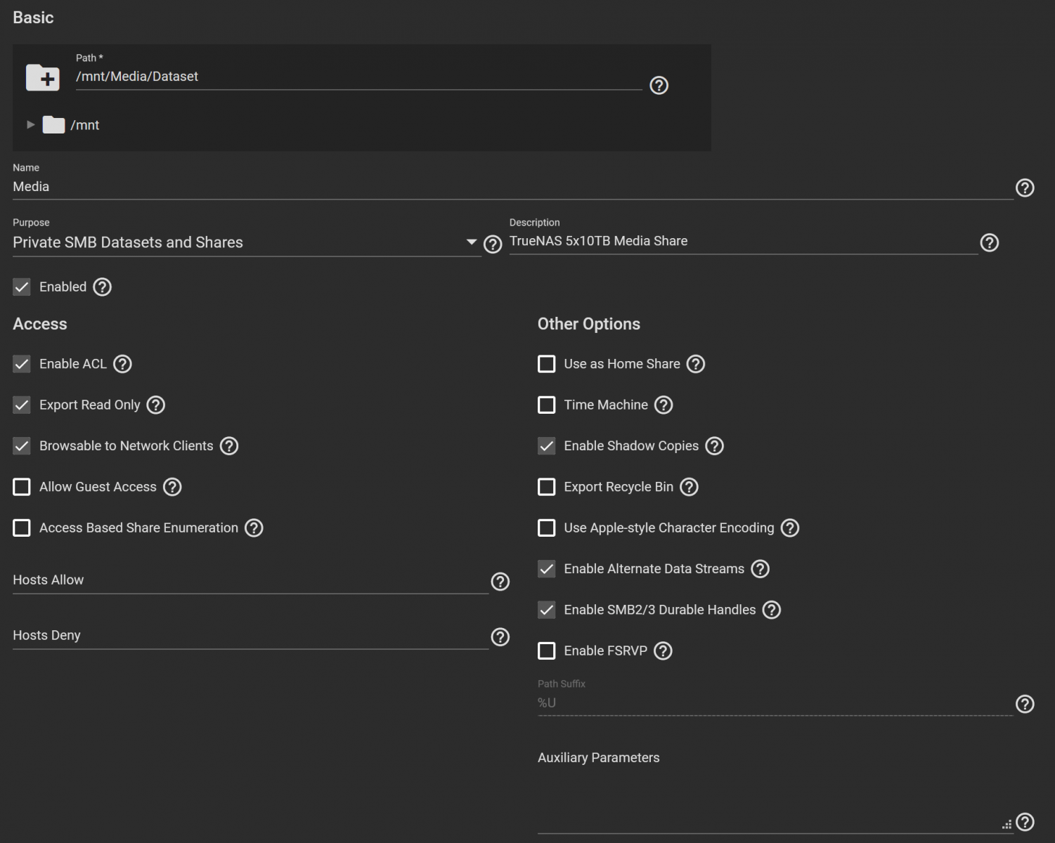

I attempted to duplicate my previous SMB settings but am getting repeated Windows 10 login failure using local created account details. SMB readyonly share is below and the 2nd is the writable share but basic layout is the same except the readyonly flag.
[folder names cropped for privacy sake]
Hopefully someone can assist quick and easy.

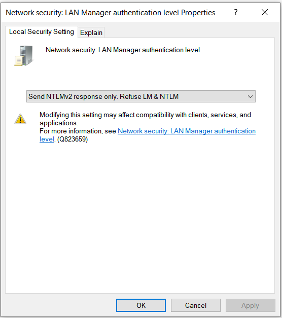

Following up - I was eventually able to get it to work with a readonly share, and a writable share. I did need to enable NTLMv2 response only under secpol.msc under Windows 10 to remove the logon prompts.
