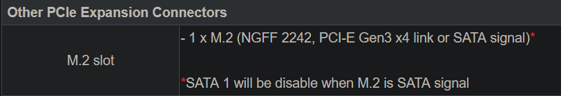

About the HBA, I put it on my list because there is this little line in the motherboard specs that puzzles me:
"SATA 1 will be disable when M.2 is SATA signal"
but it does not clearly states that it supports NVMe drives either so i did not want to risk it. It also looks like it's only a half length M.2 slot and I don't know if there are any NVMe drive in that format. I admit that I'm really confused with the M.2 stuff...
Plus the mobo does not come with an Occulink to SATA cable and I could not find those for cheap...

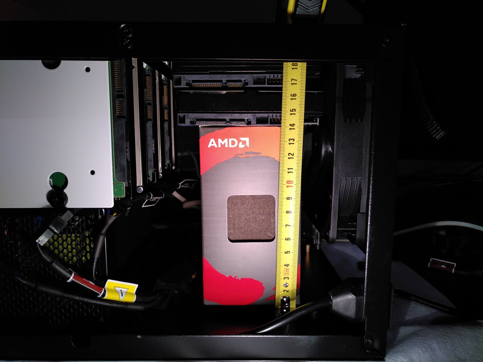

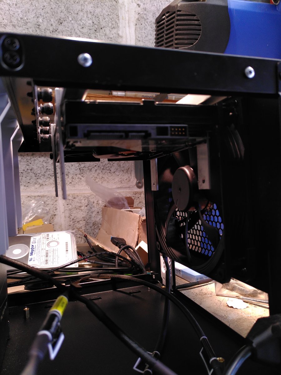

I figure a picture is worth a thousand words so here is a quick prototype of how I want to fit the 2 extra drives.
So the 2 extra drives would sit above the motherboard, at the back of the case. I'm pretty sure there is enough space to fit everything... (tape measure is in metric btw). It's more a question if i'm capable of creating a bracket that is not too janky :grin:
I want to try metal first as I have the tools, but maybe a 3D printed part would be easier? Although i'm not too sure about sturdiness and stability of 3D prints...

Sure it does: “PCI-e 3.0 x4 or SATA”. Keep in mind that NVMe is just a driver specification for PCIe SSDs.
As for the M.2 2242 form factor, that is indeed a weird one. To make things worse, there’s no 2230 attachment point.
And the oculink cables are a bit of a minefield, too, but maybe someone has figured out a safe path through.
Honestly, pretty bizarre compromises by ASRock Rack to inflate the spec sheet.

Western Digital did make NVMe drives in the M.2 2242 form factor. I've also seen other vendors with NVMe drives in that 2242 form factor. Running this search on Amazon, I got several useful hits, "NVMe M.2 2242 SSD". Including Samsung, Sabrent, SK Hynix & Dogfish.
You can order the OCulink cable directly from ASRock Rack, (though they mis-spelled "buy");
  • 4 SATA3 (1 SATA DOM included), 1 OCuLink connector with 4 SATA ports*
  • Supports 1x PCIe 3.0 x16, 1 x M.2
  • Supports Intel® I210& Intel® i219LM
    *Please contact sales to by the cable

Not a bad case mod you're proposing... maybe something that would be very popular if Fractal would do the work.
I would be very careful how you manage heat/airflow with the HBA (which will generate a lot of heat) and the disks right above the CPU though, as you may find that space was left empty for a reason.

About the case mod, airflow is indeed a concern as the disks will obstruct much of the exhaust fan. I'll try to make the brackets as small as possible to allow for max air flow. I'll give it a shot during the weekend. I'm not so worried about noise though, so if I have to pump up the fans it's not a huge problem. Heat coming from the HBA is more worrying to me, as there will not be much airflow in that corner of the case... Maybe I'll try to make a hole to fit a fan there if I see high temps in testing.
9,700
There's already a grille on that side and I have been able to sit an 80 mm fan next to it to draw air in the direction (right in front of) the PCIe slot.

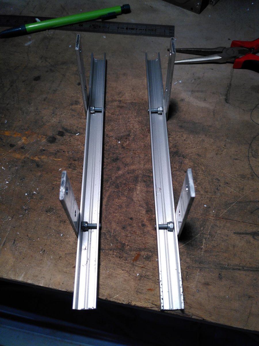

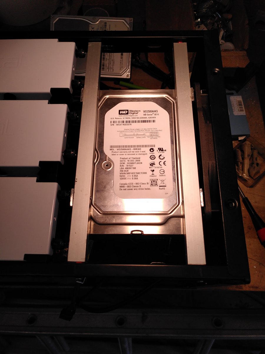

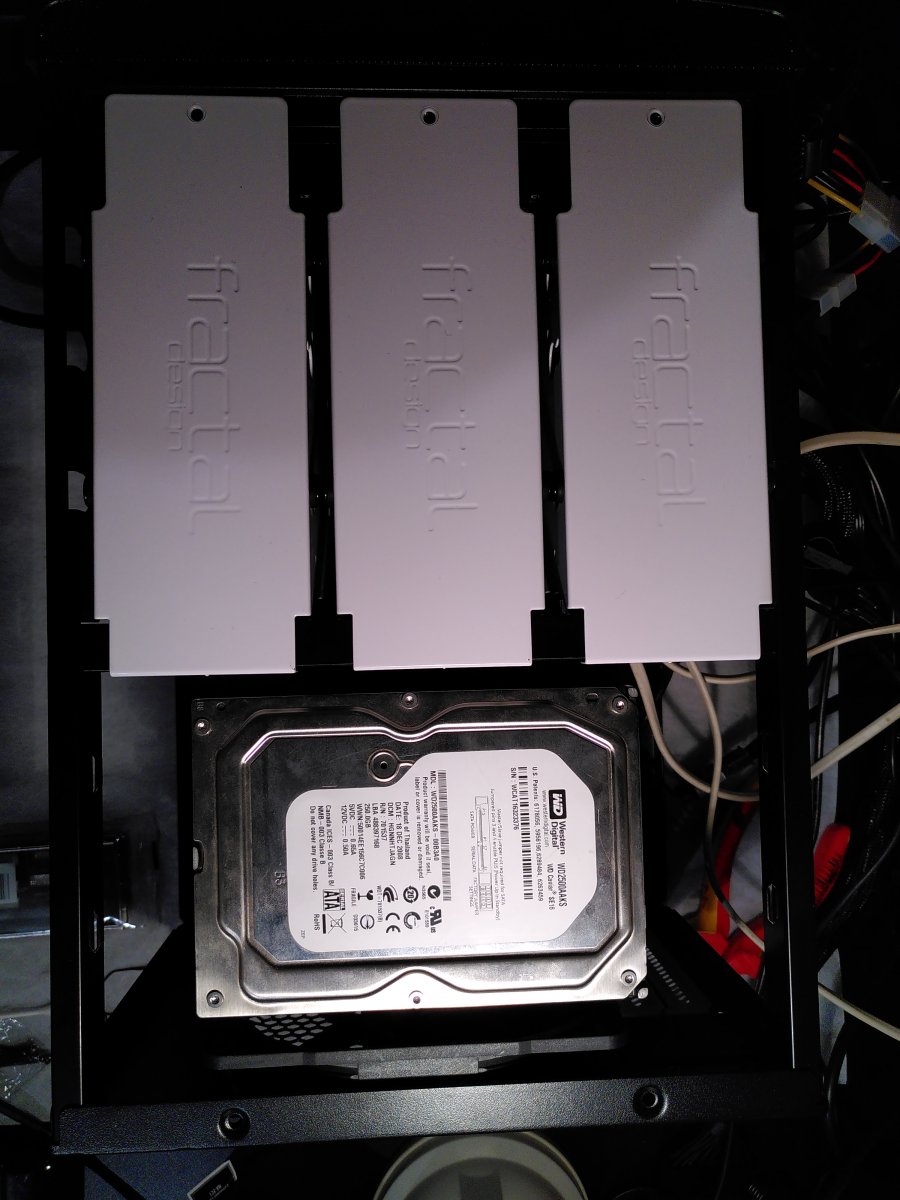

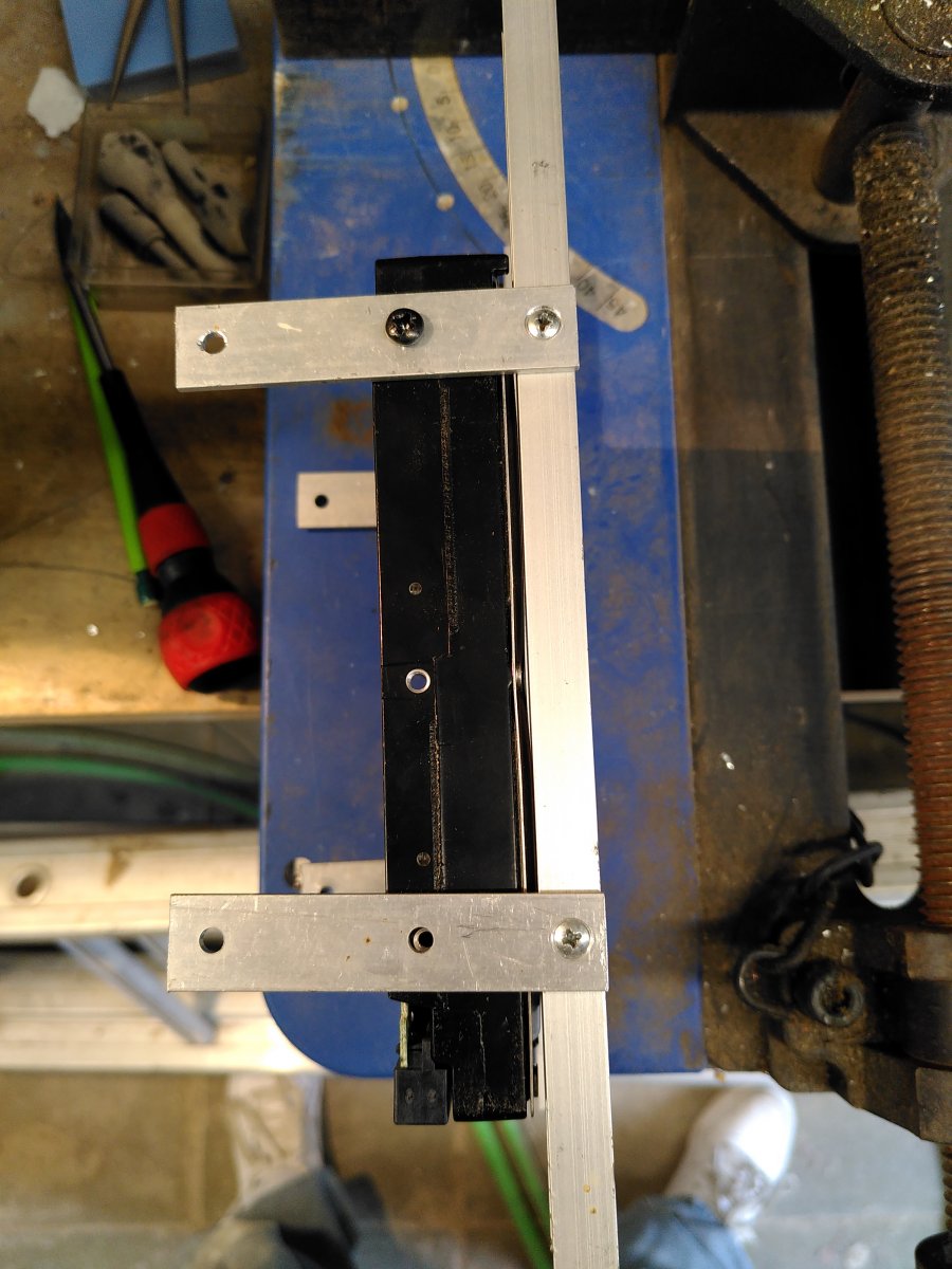

For those interested, I worked on the brackets for the 2 extra disks during the weekend, and I'm pretty happy with the solution I ended up with:
It's made with in aluminium using a "U" profile and a flat bar. The 2 brackets are attached together only through the disks themselves.
It's not attached to the case either, it simply rests on the top rails of the case using 4 extra screws that protrude towards the inside of the case.
Only 7cm deep, with 1cm of air between the 2 disks, that leaves a little more than 12cm of vertical space to work with for the system below.
I'll have to make some adjustments for vibration dampening and I cross my fingers that temperatures will be ok... I will probably create a dedicated thread when I have done some tests and have some numbers to share :wink:

My +2 HDD casemod works fine so far, only spacing issue I had was between the CPU radiator and 140mm fan at the back, so I just mounted the fan on the outside of the case for now

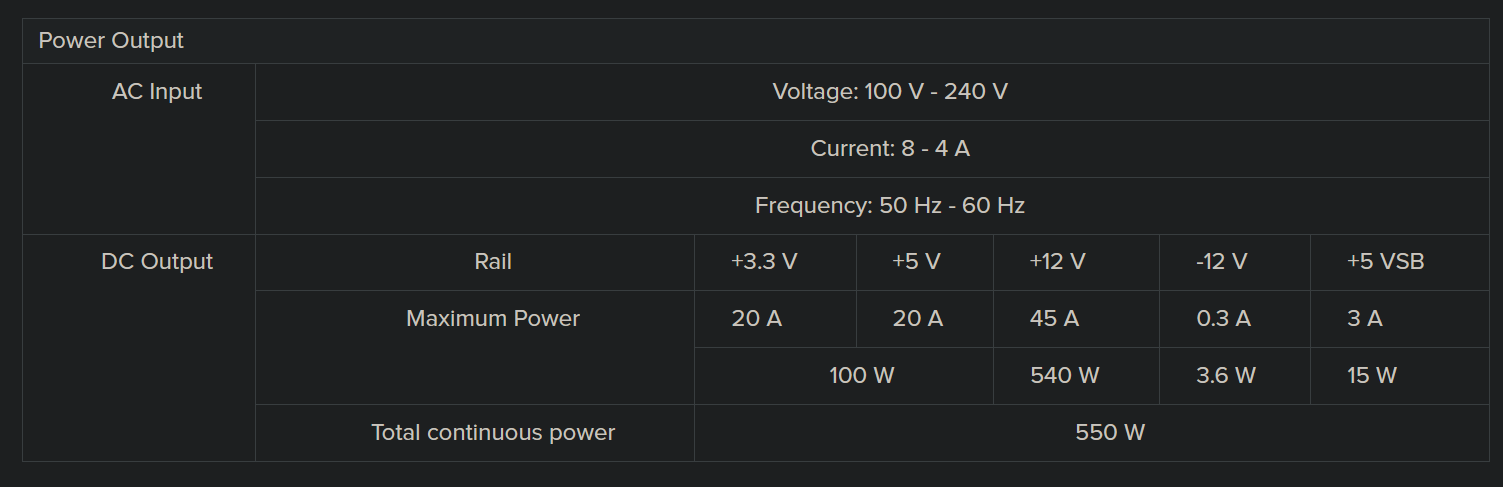

Now, about the PSU, these are the specs from Seasonic:
And this is what i estimate:
Mobo: could not find any number... max=60W?
CPU: TDP=65W... max=80W?
RAM: 10W
SSD: 10W (Corsair says 6.7W average)
Fans: the 4 fans combined are about 6W according to Noctua
Total: ~170W
Now for the drives, I plan to use 8x WD101EMAZ 10TB.
They are 5400RPM non helium RED derived drives according to this
On the label it is written: 5VDC 0.7A / 12VDC 0.9A. for the 8 drives, that would be 5.6A on 5V and 7.2A on 12V.
That does not seem too bad, but what i don't know is if those numbers are max or average?
Given these numbers, i'm under the impression that this 550W PSU is enough but what is your opinion? Should I keept it or not?
