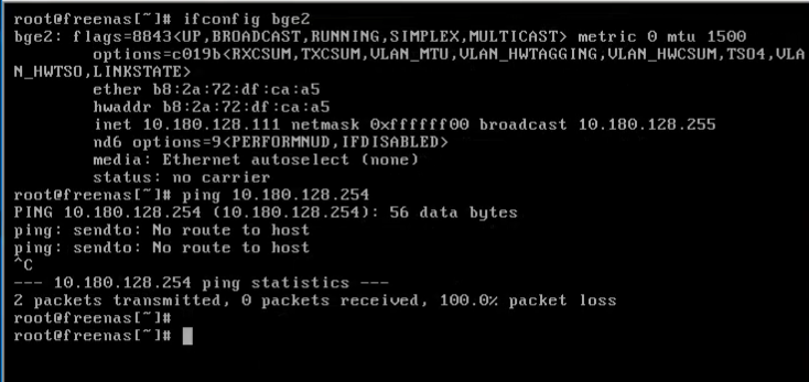

Hello,
I tried to deploy a new FreeNAS on Dell PowerEdge R820. Unfortunately, I am facing a very nasty network problem, bge2 seems is not able to communicate with gateway, web console also cannot be access.
Has anyone have the same issue and know how to fix it?
Thanks

Usually, this is a cable issue. Are you sure you're connected in the correct port on the server?

Cable and port are no problem because before that I have deployed Windows Server 2016 on this machine and the network is working properly.

The NIC numbering isn't the same between OSs. Try moving the cable around until you get a working link.
