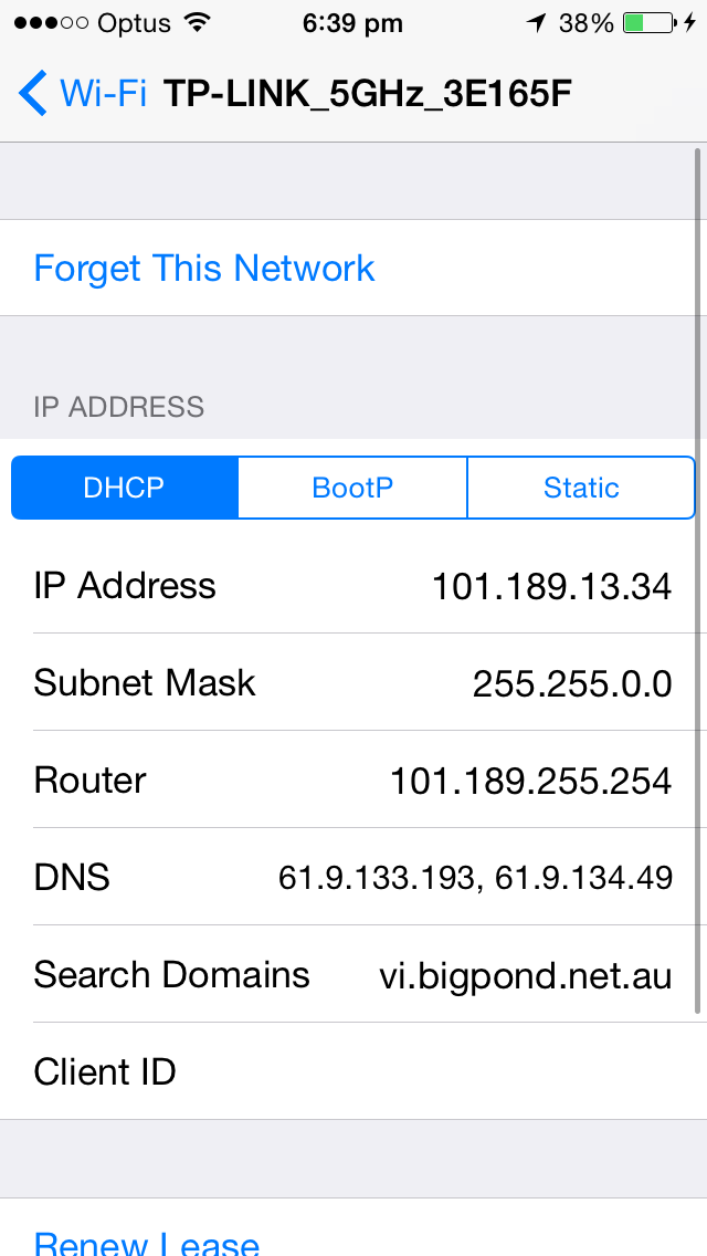

My setup is rather simple, a modem/router in one with two WiFi networks come from it (2.4ghz and 5ghz) as well as the HTPC and NAS attached by gigabit.
I think I may have uncovered the root of my problems though, my iPhone!!!!
For some reason it connects to a domain that is not on my local network (vi.bigpond.net.at <--this is hosted by my ISP), not sure how its done it but see the attached picture.
Connecting to this domain makes it invisible to the rest of my network.
The iPhone using an invalid IP makes my router go crazy and some other devices start to get invalid IP's as well. Then the router slowly dies. (strangely the internet still works on all devices most of the time though)
If I force the iPhone to have a fixed IP on my network I don't seem to have all the problems, at least so far.
Why this is happening, I don't know. I can't tell if its my modem/routers fault, my ISP or iPhone...

Is it possible that the iPhone is connecting to a cellular network and trying to share it around your LAN? Do iPhones have DHCP servers? If they do, I'd disable it and tell it not to share it's own WAN connection.
I don't think any phone does that over an existing WiFi network.
Typically, it's only done with peer-to-peer networks started by the phone.

The pic I posted was taken when I had the cellular network turned off on my iPhone, so I doubt that, plus my phone is with a different company

We don't know all the details, perhaps some of the OPs devices have wired connections to his LAN and WiFi to the phone? Perhaps they are both using the same subnet data and DHCP packets are leaking across? It must be either the iPhone or his router allowing inappropriate settings.

I'm no networking genius but it seems to me like my ISP's DHCP server are leaking into my network some how.
Interestingly this all started to happen around the time I updated my phones OS and when my ISP started to offer a new service called 'Telstra Air' (basically setting up a hotspot for other Telstra customers to use from your connection, with a special modem/router) I didn't sign up for it but maybe they had to make changes to network settings on there end that have effected my router/modem

Sounds like something odd is in that router. That ip address on your phone should NOT be given out by a fully working DHCP server, which points to the dhcp service on the router going haywire.
There is some bizarreness going on in that router, and having a publically routed IP on an internal device, especially if its advertising any network services like DHCP will be causing massive issues.
Time to get that router looked at. Perhaps save your settings, default to factory, flash to latest firmware and start from scratch.

It shouldn't be this difficult :/ my modem/router wasn't the cheapest it shouldn't be having these issues... :(
I've upgraded the firmware and reset to factory setting and started from scratch but it made no difference. But as I mentioned above, fixing the IP on my iPhone has solved the problem it seems for now...
